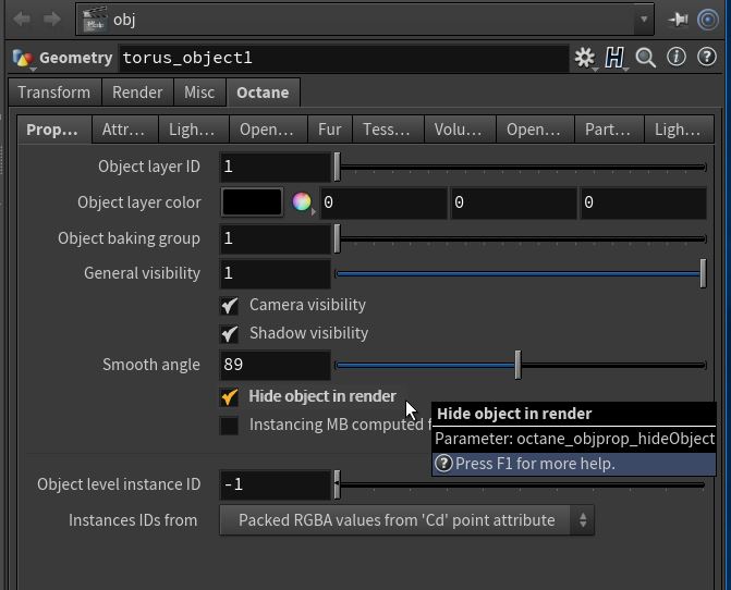

I have an instance object. The object is applied to points (using instance node). Everything on this step works well. But, when I'm turning off display flag of the main object, on the IPR everything is hiding also. Question is: how can I hide instance object without hiding derivatives?

You have an option in the OBJ Octane spare parameters to hide the object. If you fully disable the object, it can't be instanced, as you have found.

Ha ) Thanks a lot, Juanjo.
