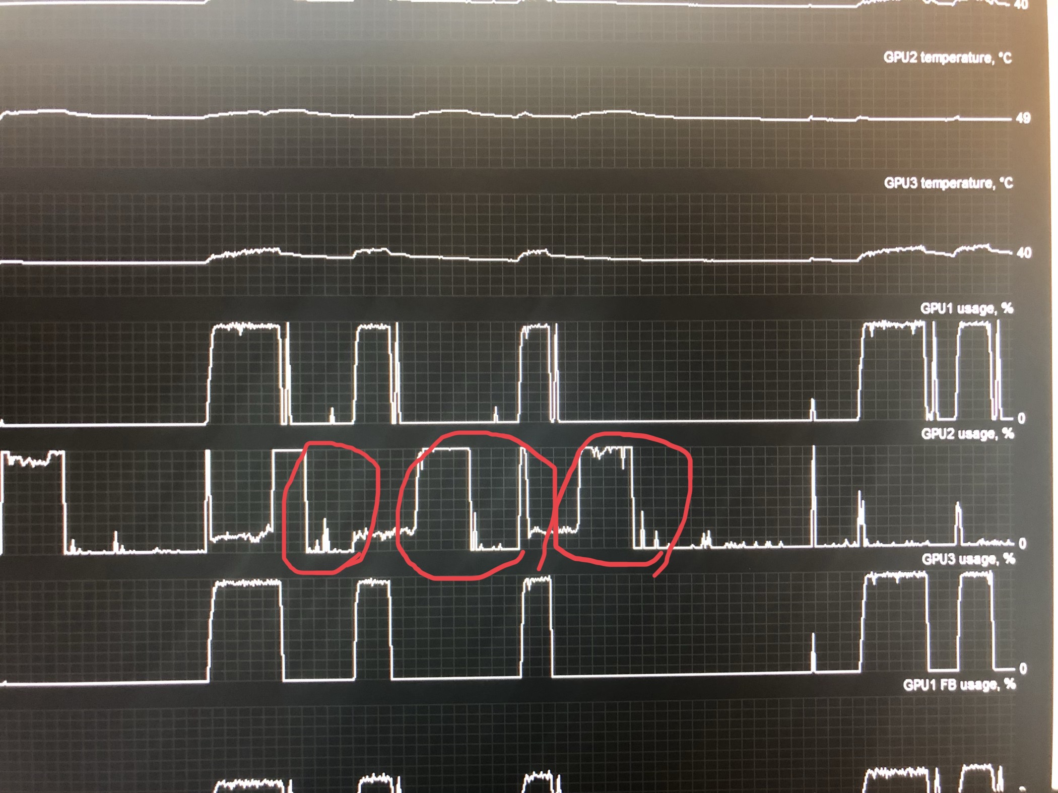

Could you also forward this picture to them maybe it will help. With phoenix present (especially multiple grids) in the scene not only eval times are long between each frame but also GPU2 kicks in that is not even used for rendering and it is a display card only. Not sure why octane uses it since phoenix loads sim from a hard drive.
