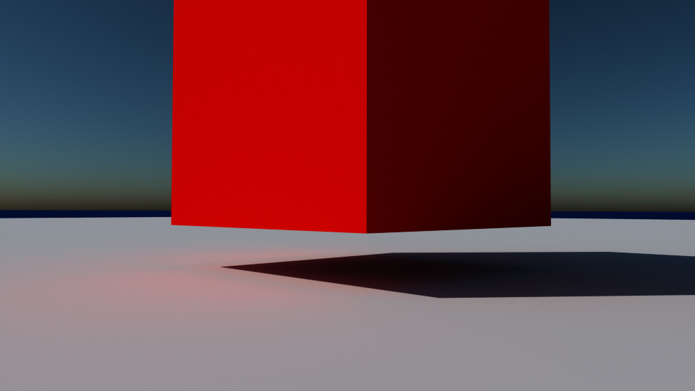

Thanks Funk, this does remove the direct shadows, but not diffuse shadowing and there's some colour bleed as well.

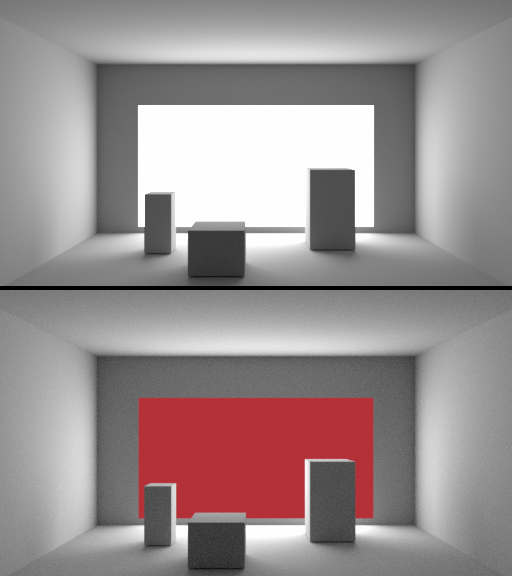

Box A
Box B
Clearly there's diffuse colour bouncing, but also some diffuse shadowing to the right of the box... subtle but it's there.
- the red box has zero emission, basic diffuse material everything zero'd except diffuse colour and opacity
- live geometry enabled
- shadow visibility off

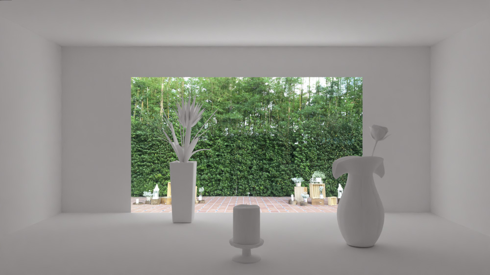

This is probably a better everyday use example. Simple room with a few objects in it and a single poly mesh item outside the window:
Scene
Sun &/or environment lighting setup to my liking, backdrop item hidden:
Add the backdrop mesh item.
- Shadow visibility OFF
- Material set to Emission
- Visible on Diffuse [OFF]
- Visible on Specular [ON] (although no items in the scene have specularity)
- Transparent Emission [OFF]
- Cast Shadows [OFF]
Scene is now noticeably darker, and adjusting the exposure doesn't really correct this as the light-falloff also changes ie: the highlights aren't as smooth and evenly distributed and shadowy areas are more contrasty. In some scenes I notice a colour cast coming from the backdrop item into the room. Sometimes I'll want to have multiple (single poly) backdrop items and layer them ie: sky, treeline, single trees, cityscape and it's gets a little worse the more I add.
Workaround for my current project: Rendered the image with no backdrop items and with 'Alpha Channel' enabled in octane kernel. Add my backdrop layers in photoshop. Why doing this sucks: backdrop reflections are not rendered into the scene.
Surely there is a way to add a visible mesh item which does not effect the lighting solution in any way?

Dino, if you dont mind using some OSL, you can do this with raytype
Here is an example which makes the background poly visible to camera and reflections rays only.
The osl plugs into the material's opacity channel. It sets opacity to 1 for camera and reflection rays, but 0 for all other rays.
Here is what it looks like. My room material (mat2) has no reflections here.
oct4_cam_and_reflection_only_with_osl.zip
(12.69 KiB) Downloaded 215 times
