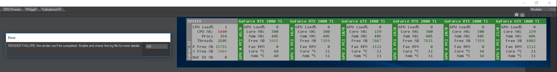

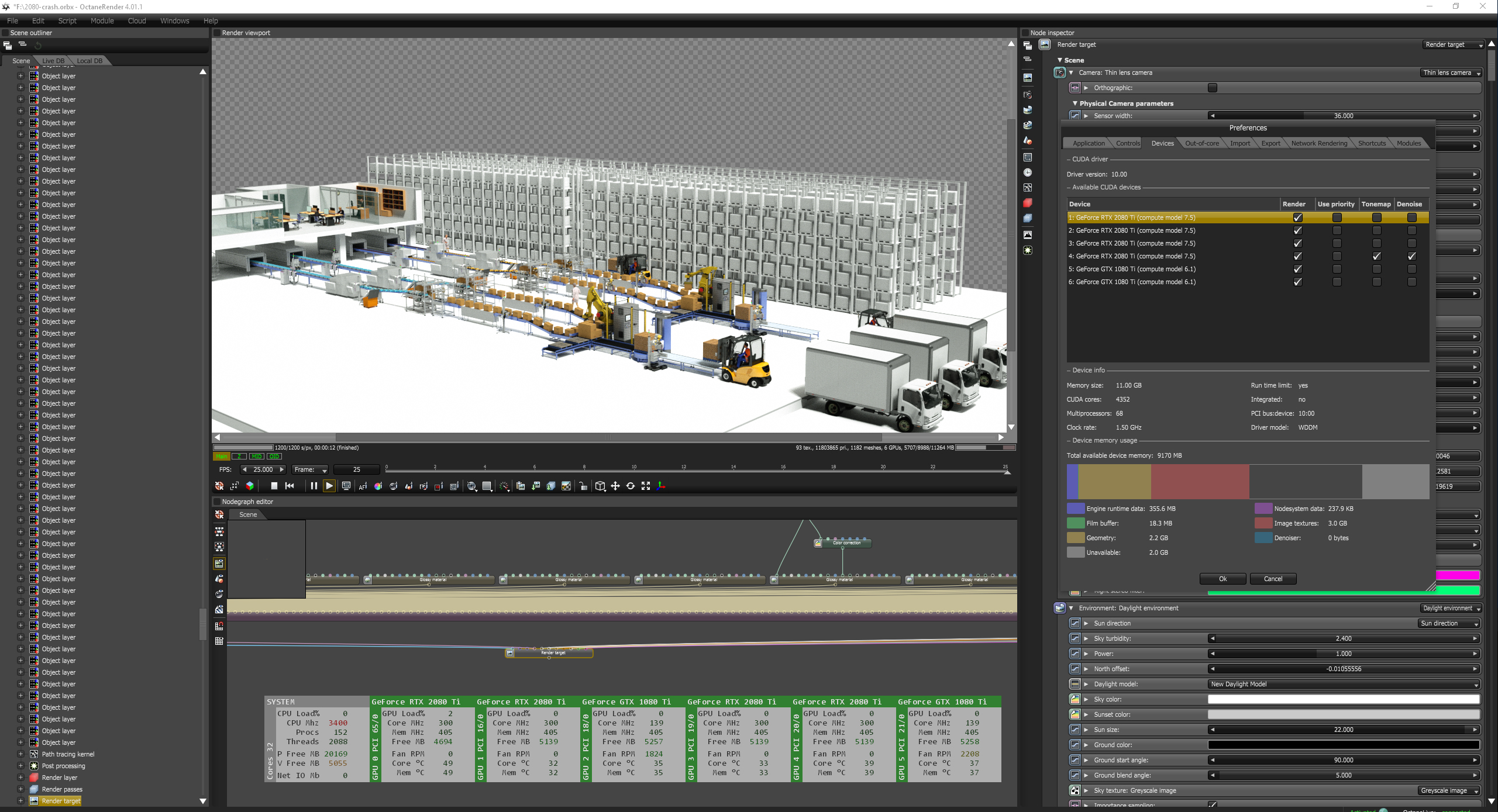

I still have this bug with the new build v4.02.1, bug got a screen grab of the mem usage after the scene has loaded to GPUs & starts to render.
Lots of headroom, as the image is only 1920x1080. Fails on the GPUs that have the most RAM too.

The same scene in the standalone renders without any problems.
