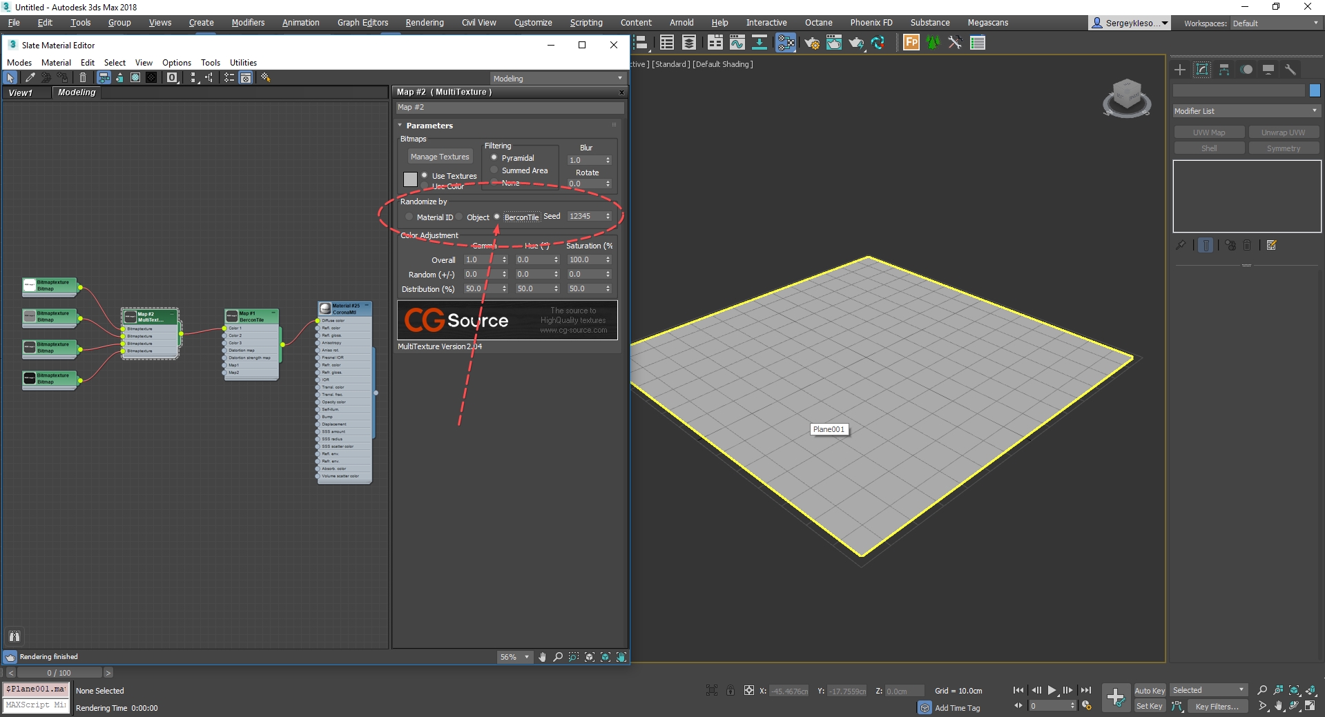

I'll try to explain as clear as I can, using Corona Renderer as an example
1) I have single plane and 4 different textures which I need to apply to this plane in a randomized way
2) I create Corona material and apply Bercon Tile to the diffuse slot. Bercon Tile - it is a simple tile generator. In it's settings I need to choose simple random grid, similar to checker pattern but with random distribution
3) Then I need to plug multi-texture in to Bercon Tile's Color slot
4) In multi-texture I can choose which option I want to use for random distribution: Material ID, Object, Bercon Tile. All of suggestion above can use only separated parts of one objects, or different objects
So basically I need something like a tile generator in which I can plug different maps
Preview of Octane's Random Color looks perfect, but how can I plug different textures to it and apply to single mesh
I've upload some screenshots
Cheers

- paride4331
- Posts: 4004
Hi SergKlyosov,
In this case I have not a workaround for you, but I can assure you that I'm pushing my best to have a multi-texture node.
Regards
Paride
Regards
