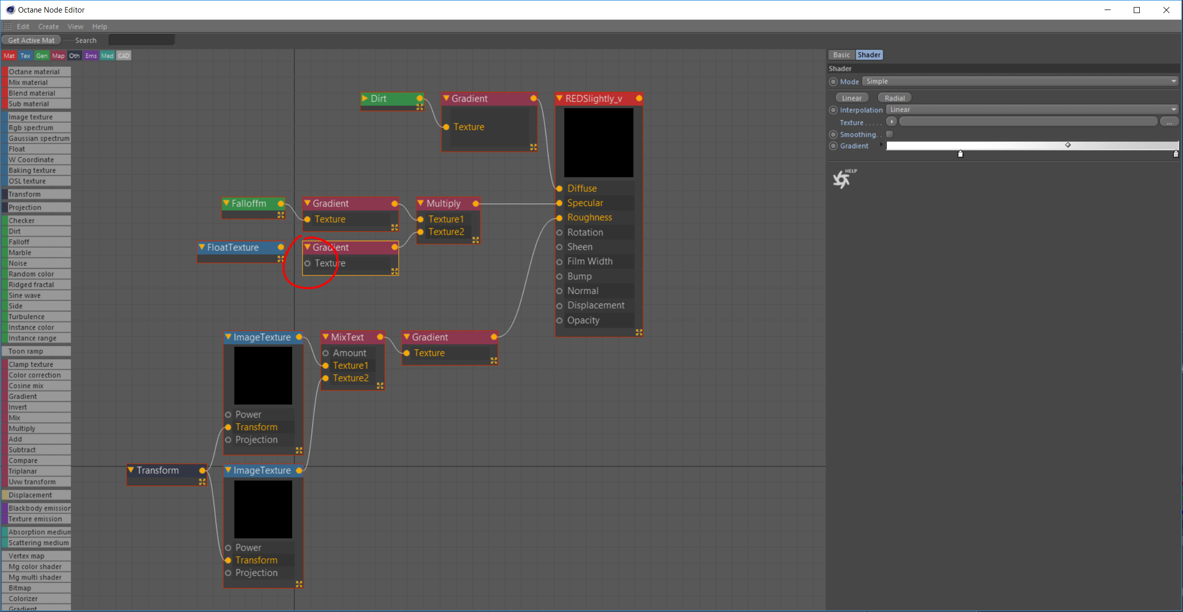

We have isolated the issue to Image Textures within materials having a very slight luminance shift in V4.01. Although it is a very slightly brighter, this ends up having major repercussions on the material response as the color is mapped to Gradients, Mixes etc.... in the Specular and Roughness channels.
There is a new dropdown menu in V4.01 "Texture import type" which is defaulted to Auto. Could this be interpreting the color slightly different than in V3.08?

We've solved the brightness shift after going thru the shader network node by node. The difference was the result of the Gradient assigned to "Texture2" of the Multiply node not having anything assigned to the Texture channel. By linking a FloatTexture (value 1) we were able to get the V4.01 render to match V3.08. It's strange that the unassigned Texture channel in the Gradient would produce a different result in V3.08 vs V4.01.
Gradient with unassigned texture

Good to know that these differences occur. Since your Float was 1, it seems that the empty standard value was even higher which seems really weird since you expect it to be 1.
