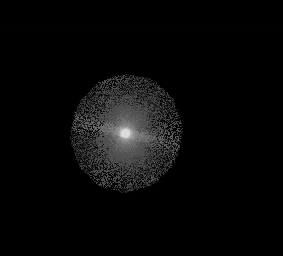

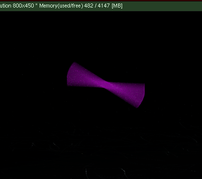

I've been having trouble with getting the motion blur samples to work on spinning objects. I've done a test with an object-level very fast spinning motion on a box. I did a render with Mantra where it seems to sample as you'd expect with 360 degrees of blur and then the same settings with Octane and it never seems to give the expected results. Is this something I've missed or is it a limitation?
Octane:
Mantra:

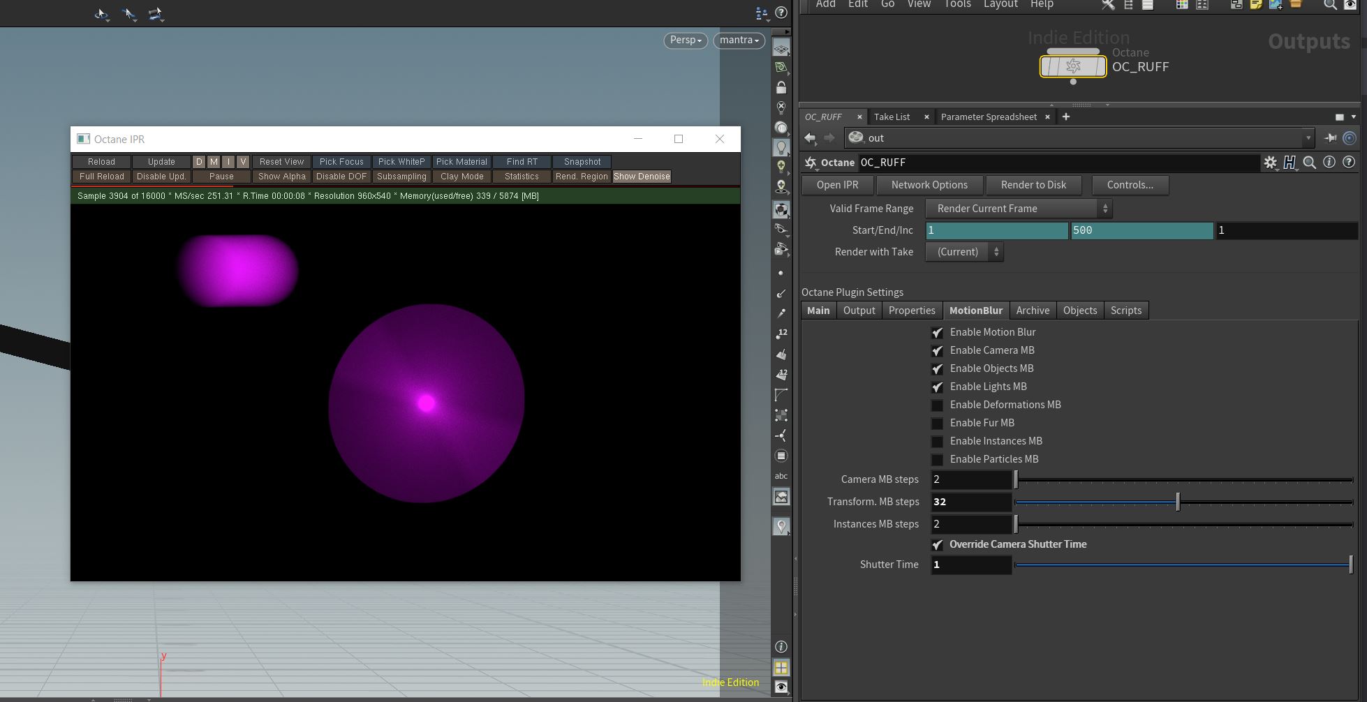

Hi Juanjo,
Thanks for getting back to me about this and that's good to know about the deformation mb step limit.
With regards to the object level steps etc.,I did play around with the mb samples and cranked it all the way up to 16 but still not getting it to behave as expected (it doesn't seem possible to push it up as high as 20). The only way I was able to get the full radial blur was to use the camera shutter time instead of the octane one and push it up to 4, but then this would mess up the motion blur on any other moving objects.
Again, it seems that Mantra on 16 steps renders with the full radial blur.

Ok. I've fixed all these issues with the motion blur for the next build. It was indeed a critical bug introduced in the latest changes made in the code to make the IPR scene update faster, so thanks for reporting it!
I've also raised the max. number of motion blur steps to 64, something that could help also in these kinds of scenes.
