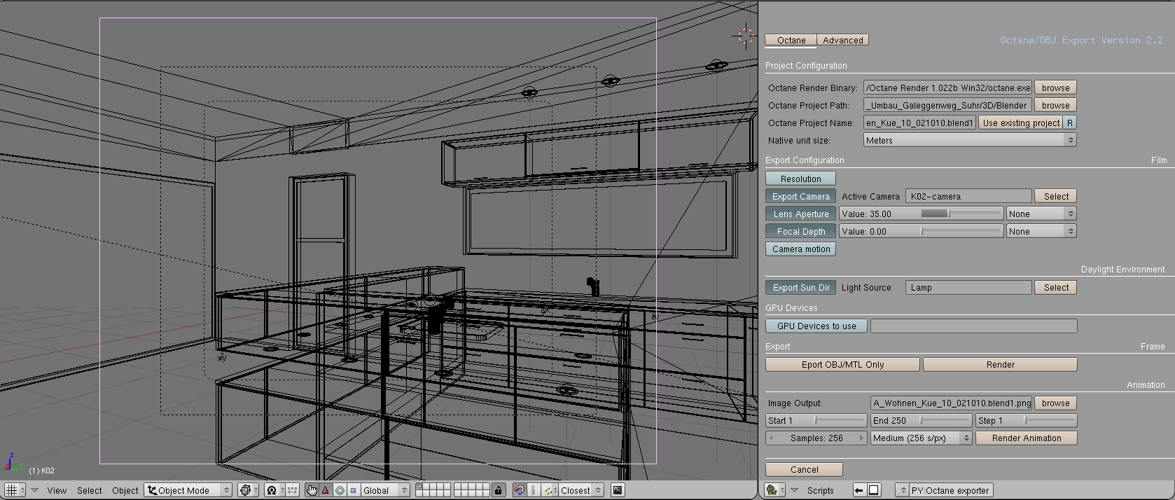

I'm doing my first steps with octanerenderer.
Using Blender 2.492 and the exportscript.
I selected the active camera in blender and clicked on the "select" button in the octance script in the "Export configuration" section.
But when I click on "Render" I always have the errormessage "camera not valid".
It even doesn't work if I enter the right name "K02" (because I think "K02-camera" is wrong). Then I get a error in the Blender console which tells me "K02" not found.
What do I do wrong ?
Kind regards
Alain
Intel Pentium 2.8 GHz 2 Cores, 8 GB RAM, GeForce GTX Titan 8GB, Blender 2.72b, Win 7 64 Bit
matej
Posts: 2083
Joined: Fri Jun 25, 2010 7:54 pm
Location: Slovenia
Both datablocks CA & OB must have the same name
SW: Octane 3.05 | Linux Mint 18.1 64bit | Blender 2.78 HW: EVGA GTX 1070 | i5 2500K | 16GB RAM Drivers: 375.26
cgmo.net
Alain
Posts: 270
Joined: Tue Jan 12, 2010 12:12 pm
Thank you, that was it :-)
I recommend to the scriptauthor to put out a errormessage that tells me the errordetails ;-)
Kind regards
Alain
