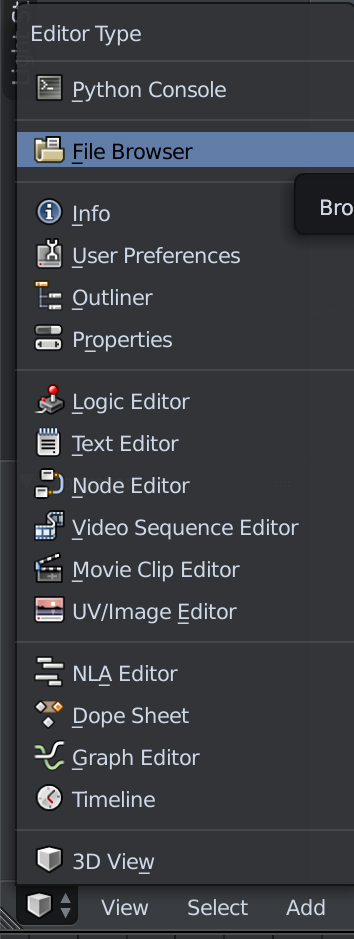

i'm new in Octane for Blender.
with the new octane for blender version (2018.1 - 17.2), the live material Library (LiveDB) is disappeared? only by me?
what is the latest version? 2018.1-17.3 or 4.02 - 16.3.2. i don't understand the order :shock:
thx for help

Hey, do you have Octane selected as the renderer? If you have Cycles or BI selected you will not see the LiveDB option.
Ah, just checked an it's not there for me either in 17.2. I think the devs have said that they are working on improving the LiveDB and that may be why it's not there.

The LiveDB/LocalDB is not an editor window anymore. It can be found at the top bar under the "Window" menu ->Octane LiveDB. It has bugs look at my bug report on LocalDB.
