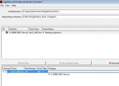

It renders only the first frame but I think NRC doesn't understand the service started the render and always stays in "starting sequence".
Very very pity.
not resolved
Very very pity.
