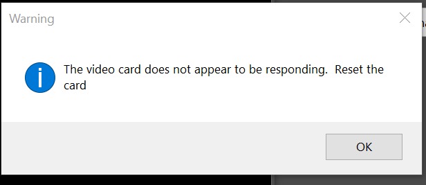

Lately I'm getting this message during/after renders. the rendering process works, and it seems that my GPU is working (games, etc...). I wasn't getting this before. the only thing I did was update my octane version to the latest one...
any ideas whats wrong and should I be worried about my (brand new) GPU?
***Update: the renders are not okay, because octane won't Refresh the scene when it's done rendering one frame...:(***
thanks, and happy new year! :)

it keeps happening again and again, on both computers (both new with 1080Ti). it wasn't happening before, so I assume it might be a bug in the new version?
Update: tried the older version and the problem persist. only with octane :(

Maybe something isn't quite right with the driver of the video card?
Something ill-gone during the installation process, old leftovers of previous drivers, something messy with the version in general ... dunno .. just wild guesses.
I haven't updated the driver of my 1080 in forever and it's still running flawlessly on 388.13

Can you please check the Octane Log button on the Devices tab, as it might have some clues. Also click the Open Device Settings and make sure you have a card set to render.

Guys, after some testing I realized that this issue only happens with a a specific save of a scene I work on for a while now. I tried to go back to a previews save and everything works perfectly as it did so far. does that means something went awry with octane's material conversion that might cause this issue?
I would not have thought that would cause the problem.

In my case, caused by Multi GPU card on one board with specific sense.
Currently, I choose only one GPU on board, almost sense has no problem.
