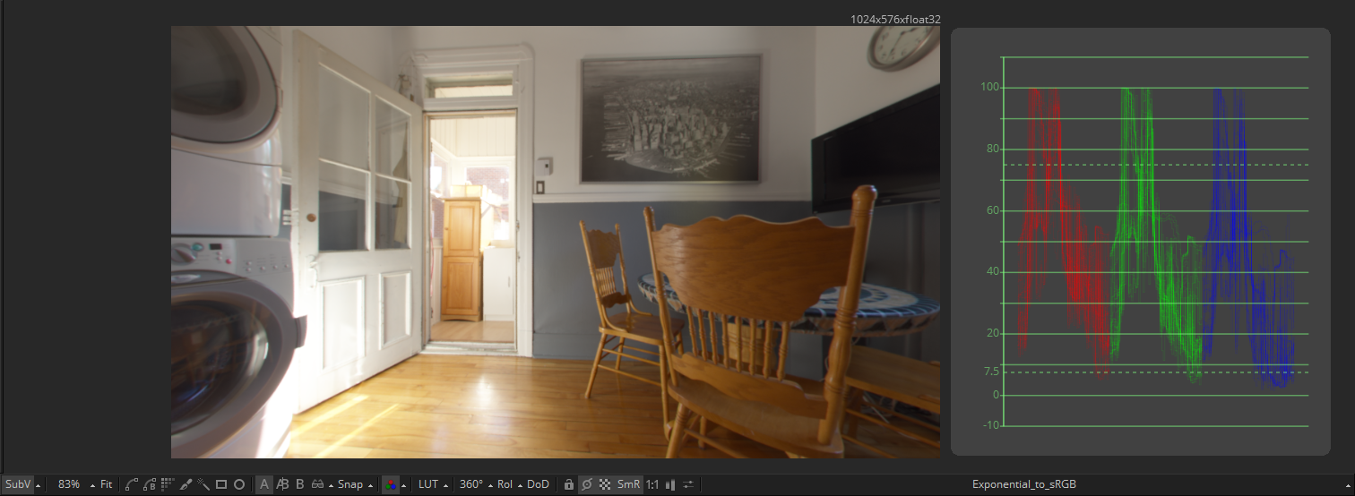

It is definitely not Reinhard. It looks like an Exponential tone mapping operator.
I was able to get very very close using this in all three channels in the Fusion custom tool: 1-(e^(-(c1/0.99))) + Linear to sRGB transform after that. The difference is very subtle. Octane Imager is clipping the highlights a little bit and both are equally horrible at handling saturated colors in highlights (notice the floor turning yellow).
This is the general formula:
https://www.desmos.com/calculator/lr5ive07lv
I used HDR texture from Maxime Roz as Environment map with power set to 1 and rendered untonemapped and tonemapped version using Exposure 1, Gamma 1 and sRGB tone response settings and a ridiculously high max sample value.
Camera Imager with Highlight Compression set to 1: Exponential TMO: I hope this helps.
Cheers
Milan
Cheers
Milan
