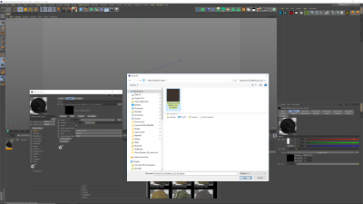

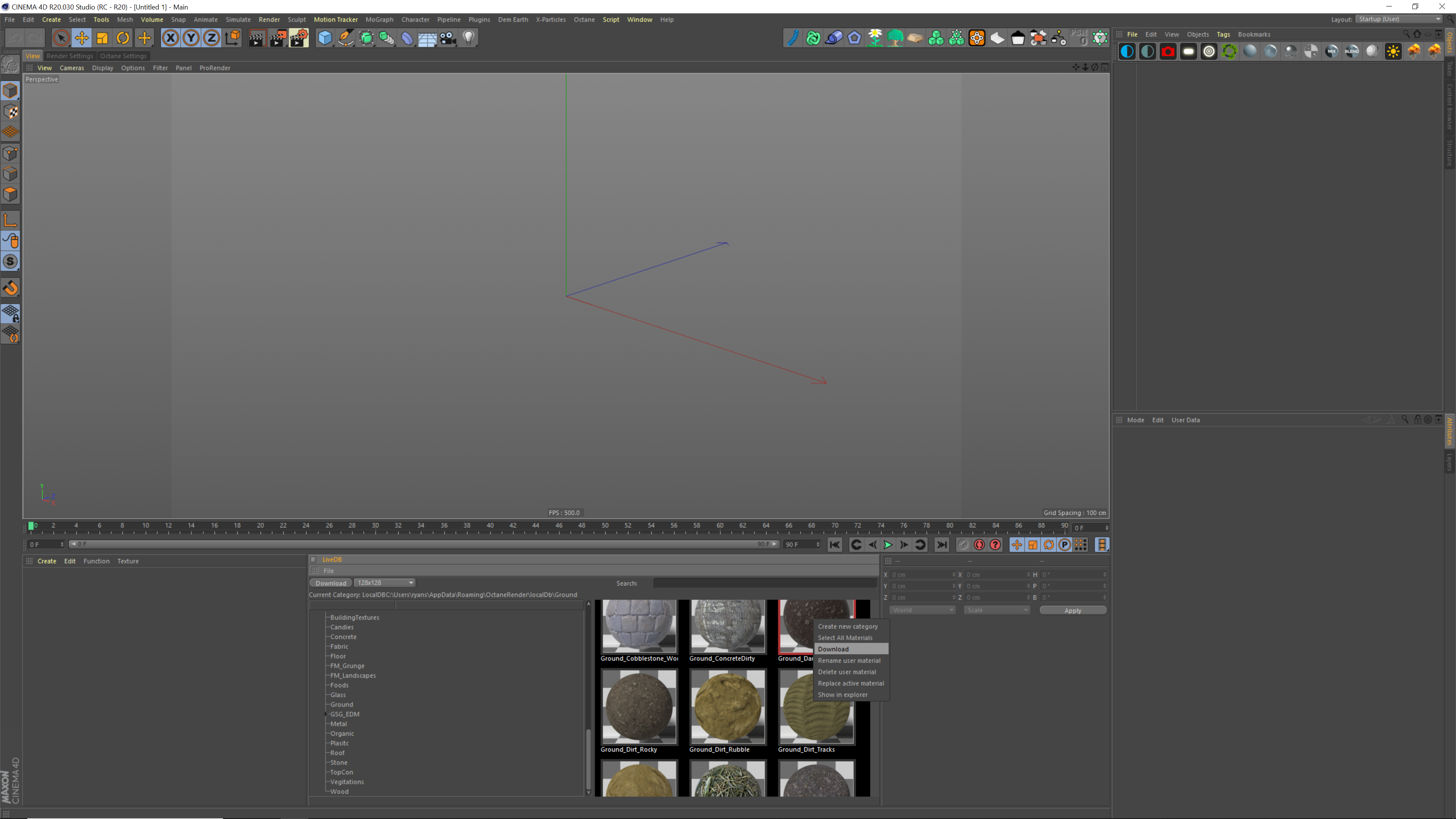

I tested like this:
I create a new material
I add an image texture
I dragged it over to the LocalDB window (like I always do) and it adds the new material to the menu like normal.

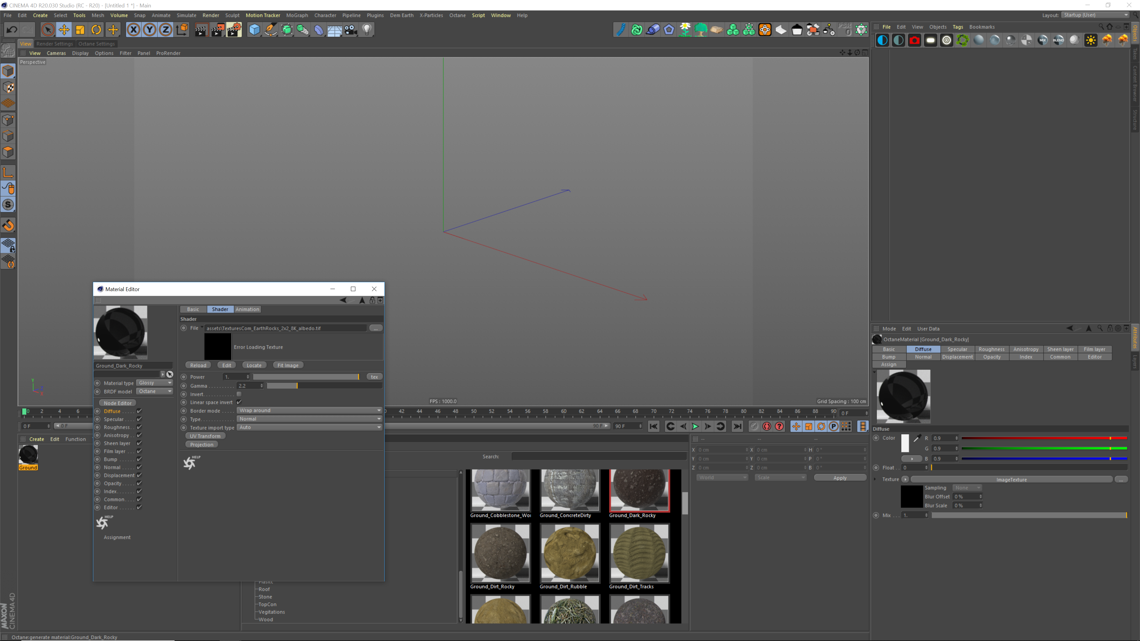

I then try to download the same material from LocalDB (Attached Image)
It creates a material with all the correct settings, but none of the images textures are linked. (Attached Image)
Stranger still, all of the file paths in the Image Texture Node are also correct, but no images are loaded. (Attached Image)
If I reload the Image Textures, and try to put it back in the LocalDB and re-download it, I get the same problem.
I essentially cant get LocalDB to save or load anything correctly.

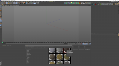

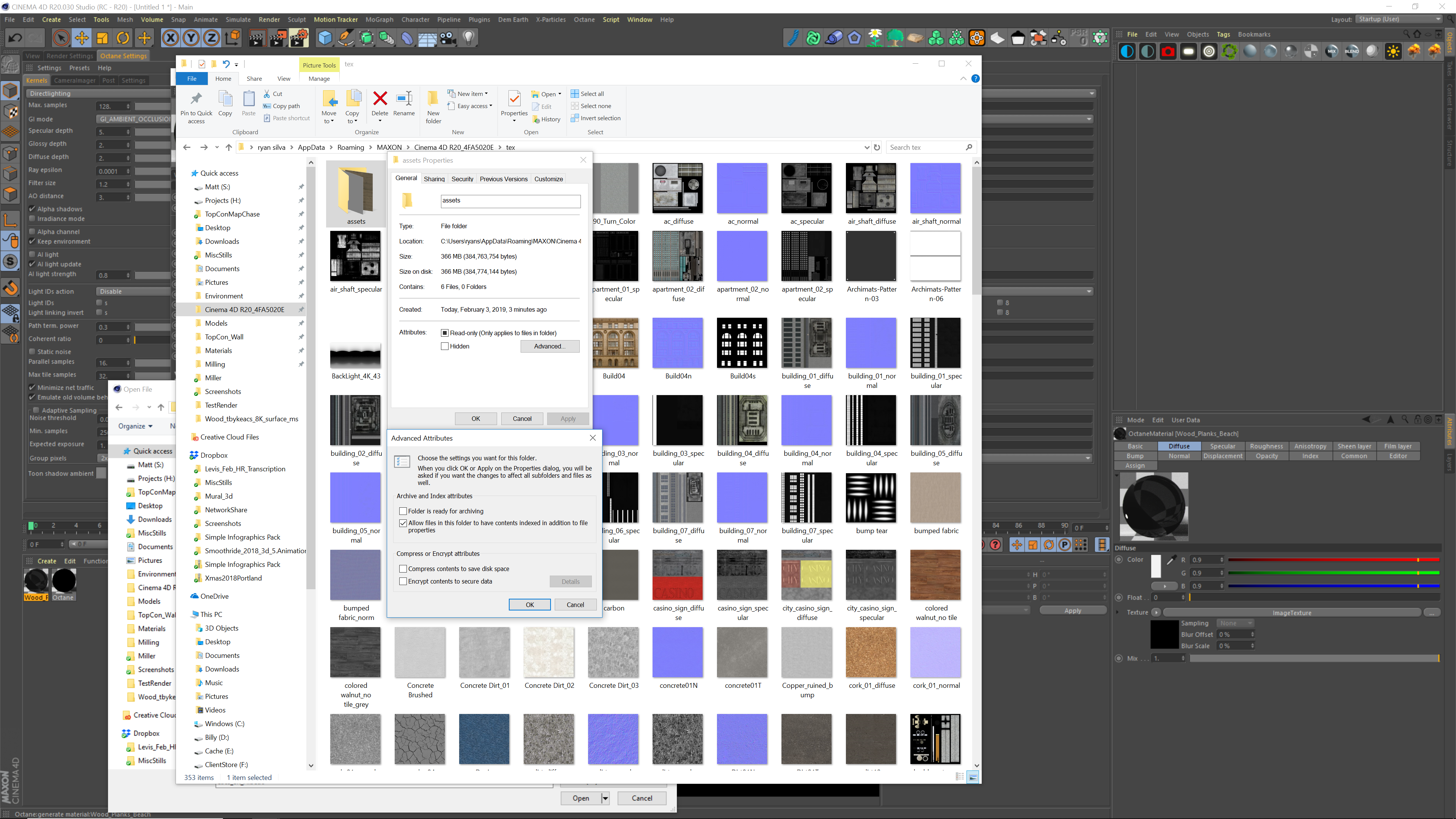

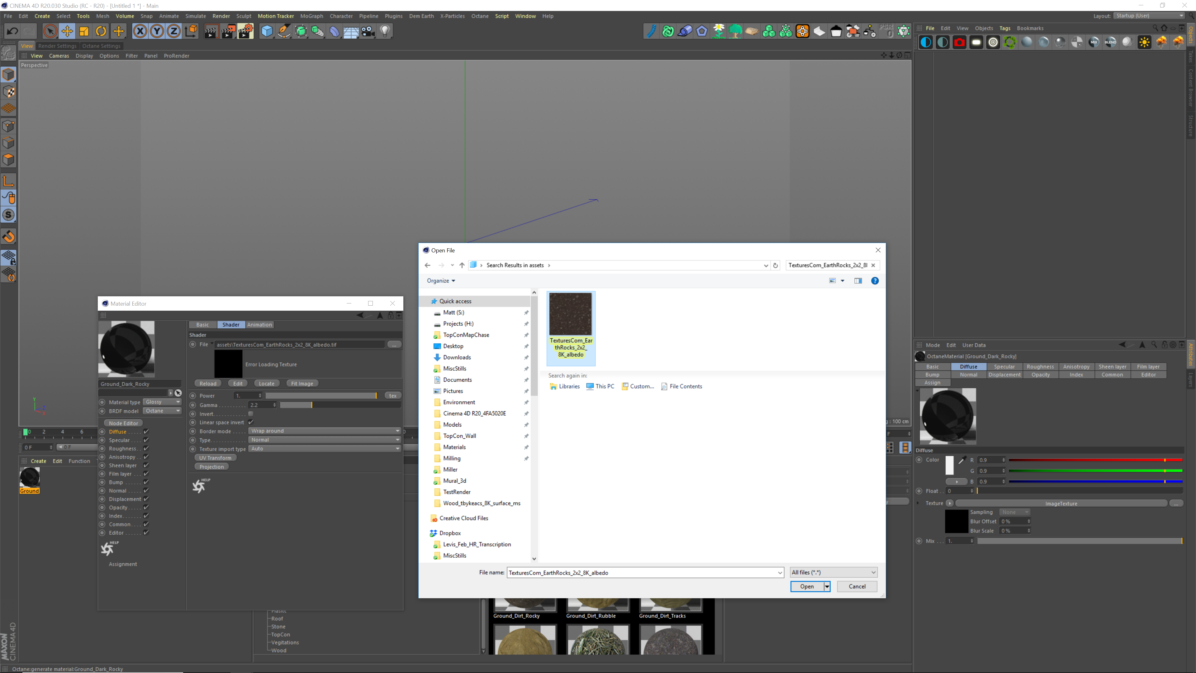

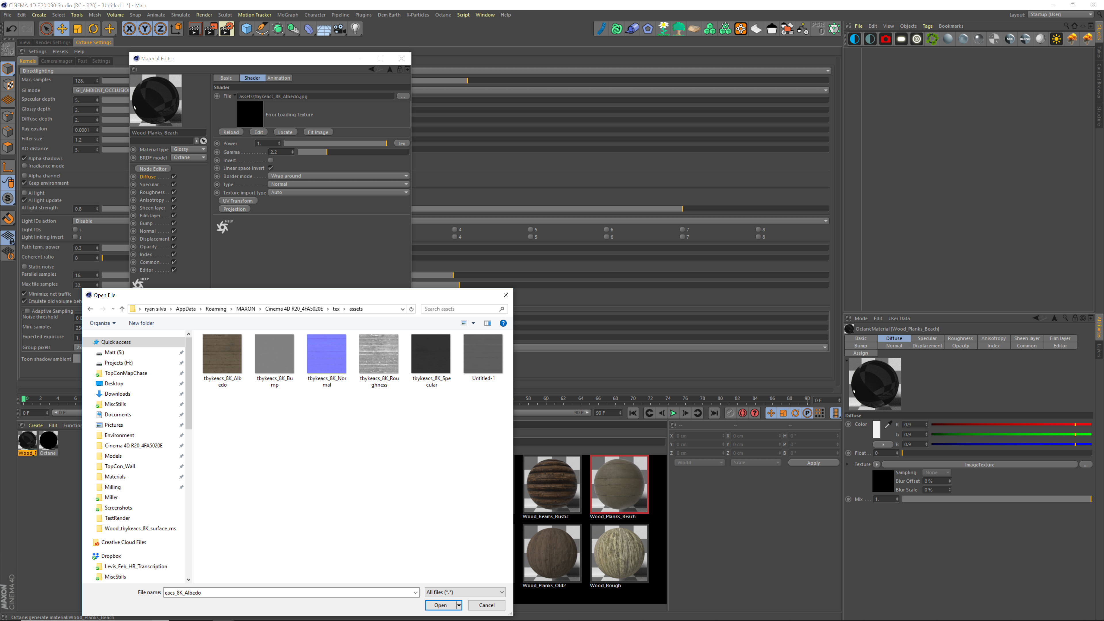

The folder "AppData\Roaming\MAXON\Cinema 4D R20_4FA5020E\tex" is where ive always assumed textures associated with non-saved project are kept.
C4D defaults this folder to read only (attached image 2) . If you try to change that, C4D changes it back on startup.
I emptied that folder and tried to download(extract) a material into an untitled project. (attached Image 1) It seems the orbx files are extracting correctly and creating the images (attached Image 1)
Its that final step of attaching the images to the nodes its not completing.
If you download materials from localdb with an unsaved scene and later you save it, then you will lose the paths. Because plugin will look to any directory under scene's dir and plus search paths of textures. Not to AppData\Roaming\..... directories. So please stop to try this and work on a saved scene.
