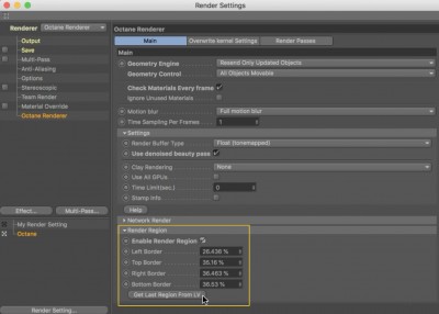

I'm having trouble understanding how to select a render region for panoramic view, the C4D view doesn't show the panoramic view so I can't select the render region properly.
Thanks,
Posts: 10619

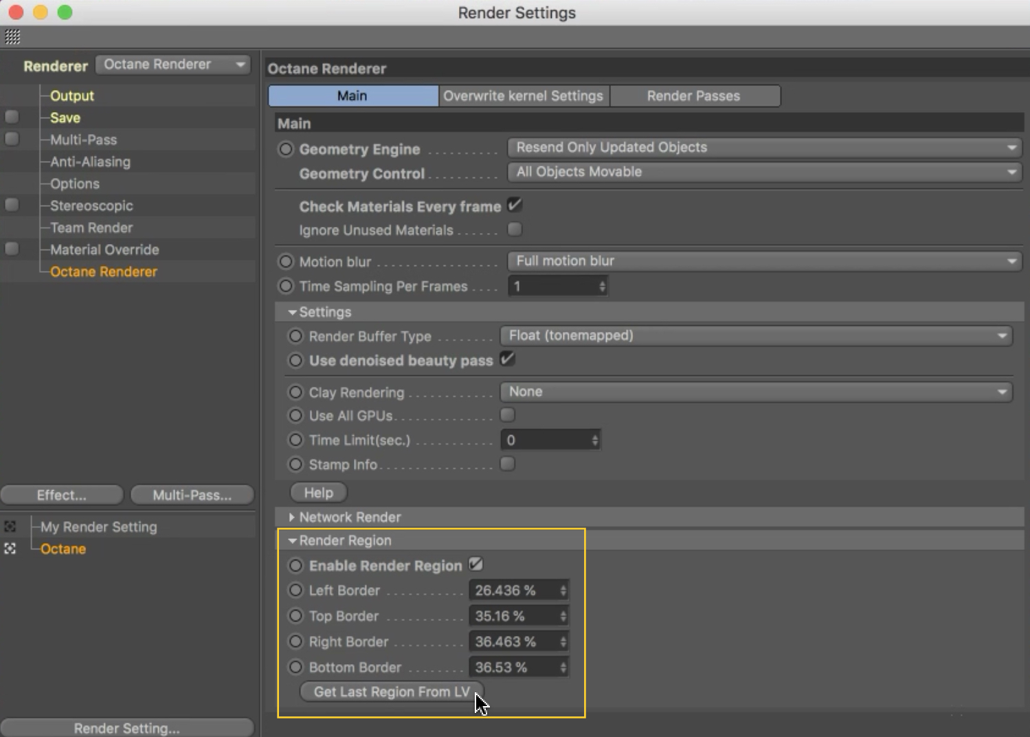

please load the scene in Live View, make your Render Region selection, then go to Render Settings/Octanerender/Main tab, enable the Render Region option, and press the Get Last Region From LV button:
