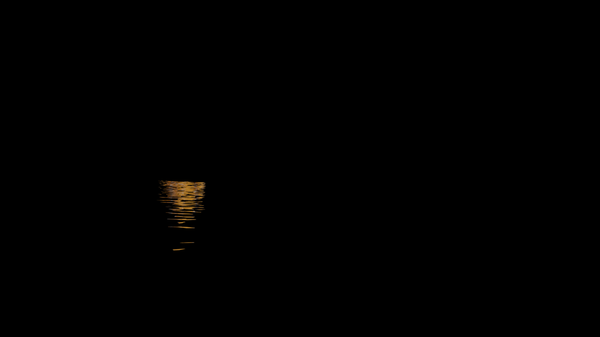

I'm trying to composite a scene with a model and a reflection in the water. I've rendered the two layers, one for the model and one for the water. Then I enabled Layered rendering with an EXR output.
But whenever I want to composite the two, the model has an alpha, but the water doesn't (even though it doesn't fill up the screen). Can anyone tell me why this happens?
mikefrisk
Posts: 172
Joined: Fri Aug 29, 2014 9:17 pm
You should set the transfer mode to screen for the reflection layer over the water layer.
