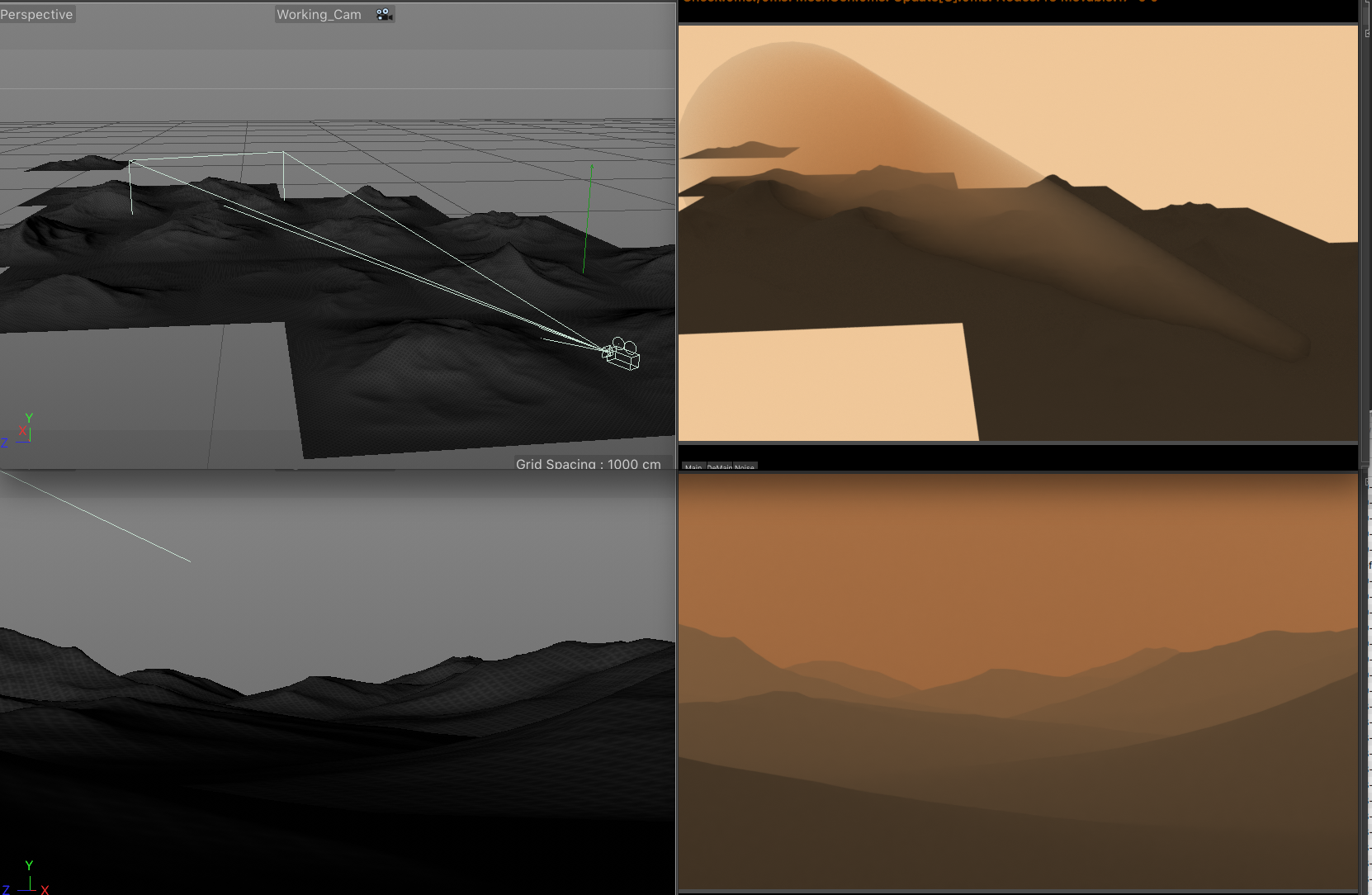

I know it's an outdated method, but if I'm not using a Z Depth pass to add fog in post, I like the old "medium applied to a specular material object in front of the camera" trick. I find it quick and easy to control, and gives good visual feedback while blocking out the scene. I know it's overkill, but I apply it to a truncated cone (covering the full FOV) that's a child of the camera so I don't have to worry about positioning the fog object. It's probably not as physically accurate as an Octane Fog Volume object, but this way doesn't really care about scene scale and renders fast. It's a technique from the Octane 2 days, but still works fine.
edit: I should mention that I've got the fog cone visibility turned off in the Editor in these screen shots. It's just a standard cone primitive sized to be slightly bigger than the camera FOV.
