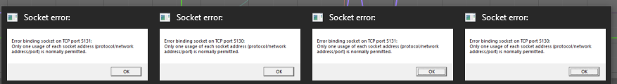

Hi JC,
Please download and fiddle with attached.
In Preview mode, this file drops the Octane Server , typically, but not consistently when:
move render camera,
rotate view
adjust shaders
zoom in and out
change vertex model
thank you,
Rick

I don't have any issues with your file. Looks like some kind of network issue. Let's wait for devs for some help.
