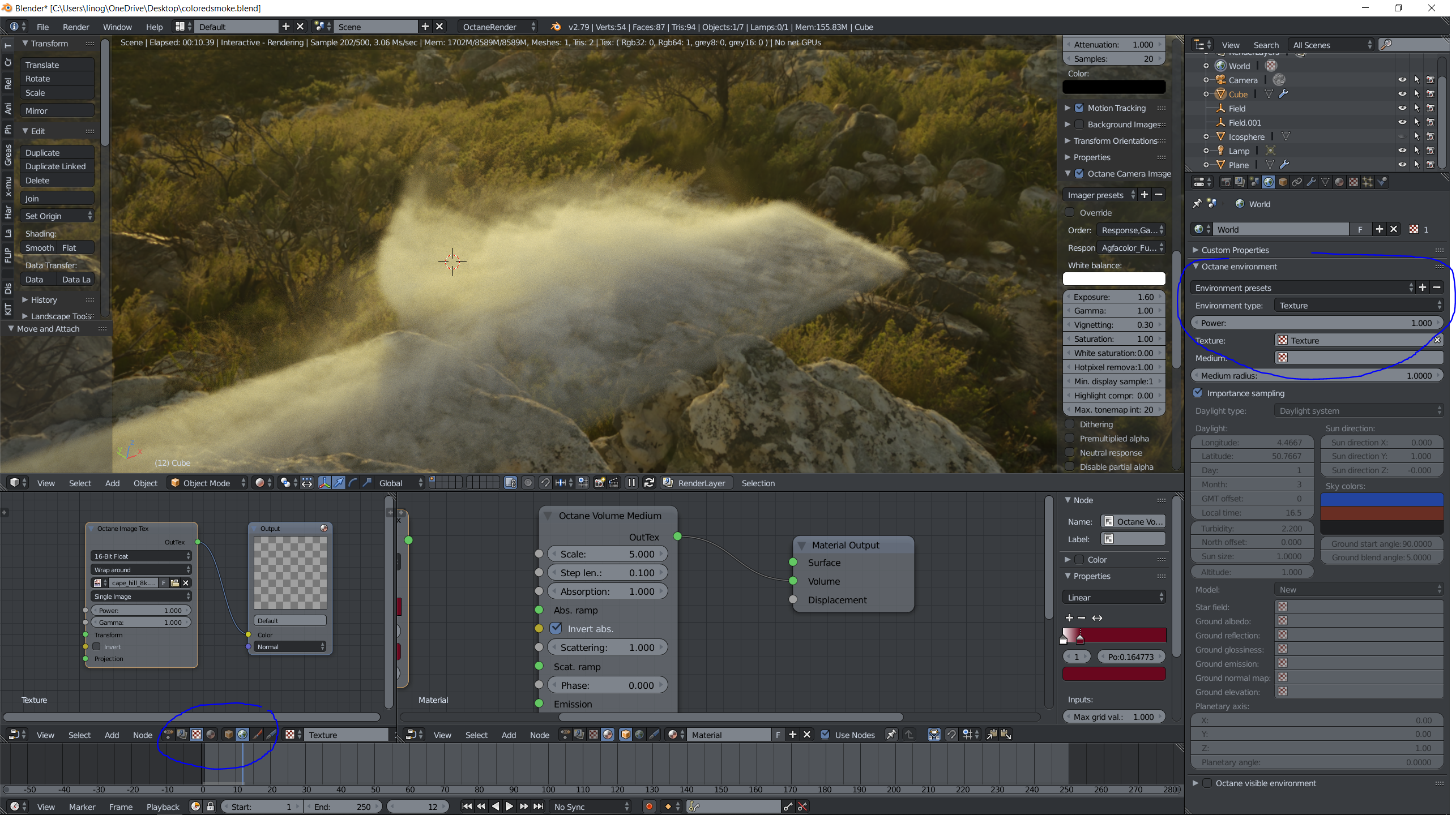

Hello, I can't seem to get the HDRI environments working in Blender Octane Plugin,
I have visual environment selected, my HDRI texture loaded in the texture slot, and Backplates, relfections, etc enabled.
But all it does is show a backplate thats pure white. The reflections seem to be showing, but I'm not sure.
Ideally I'd like to use both the HDRI and the Sun environment. is this possible?

Yeah that doesnt work. Just a white BG. Tried multiple BGs, etc.
If I open the Octane Render Nodegraph thing, it seems to work, but then goes back to just white in the render.
Can you share the file or show your settings?
