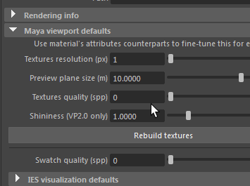

high res octane textures in viewport slow down Maya a lot,
to prevent that, in render setting set texture resolution to 1 and texture and swatch quality to 0:
