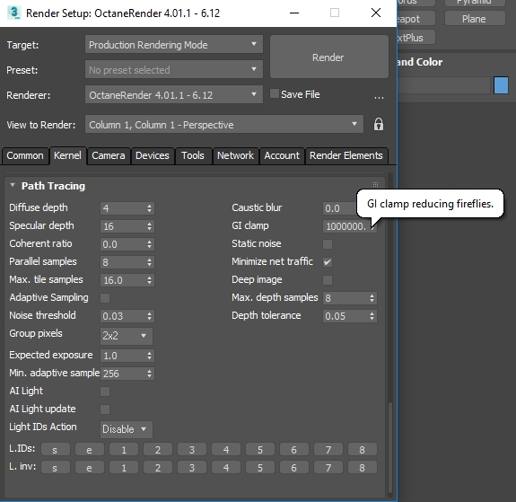

Hi. With the latest beta (and possibly previous versions), I'm encountering massive amounts of fireflies when using materials that have reflective properties in combination with HDRs/exrs being used in a separate daylight light (set to texture.) The main light is a separate daylight/sun.
I've tried adjusting kernel settings as well as hotpixel removal but it's quite brutal on some of my scenes and I don't know if this is a bug or simply the way HDRIs can interact with reflective mats (specular, glossy, and universal.)
Please advise. Thank you.

Hi lunarstudio,
Try to set GI clamp to a lower value

Thanks Paride. Bringing the GI Clamp down to 10 REALLY helped.
I wasn't expecting to have to do that. Why is this value set so high by default?

Elvissuperstar007
Posts: 2611
Location: Ukraine
HDR gamma 1.0 always change
CG clump 5-10
Ai light turn on
Filter size 1.0 detail
adaptive samplig turn on 2х2
ai denoiser turn on
