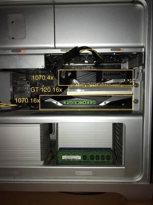

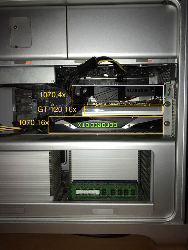

With Mac Pro 2009 (like mine), you need to upgrade to Sierra or High Sierra, then use the GT 120 for display, and add a couple of Pascal GPUs, like 1060/1070 without external power supply:
Or add a couple of 1080ti with external power supply:
https://youtu.be/5FWXgQSokF4
ciao Beppe
