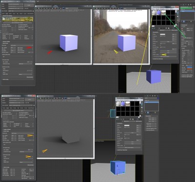

you have to check shadow catcher in diffuse or universal material.
