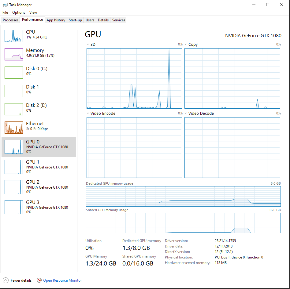

There should be more than enough memory on our systems to handle the denoiser. Here is a screenshot of my task manager.
Also, it's worth noting that this appears to be an Octane 4 problem across all the plugins. We have a guy here that uses Lightwave, and just out of curiosity I had him render a 5120 x 5120 image with denoiser turned on, and the same thing happened in Lightwave. It just closes. (4k as well)
The big spike you see is where C4D crashes.

please check System Memory RAM, not GPU Memory, when denoising is active.

I don't think the system memory is an issue either. It is visible in the photo that I provided - it does not reach a peak.
I am using a very simple scene. A cube with nothing else. There is no reason AI denoiser would take up 32 GB of system memory just rendering a basic untextured cube.
