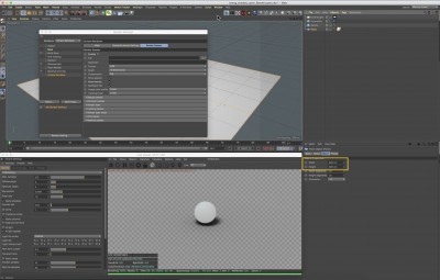

I'm sure this is a known subject (it´s even on reddit but unsolved) but I've read and watched tuts and I can't seem get a solution. This image illustrates my problem
So I only want to keep the shadow from the sphere, but don´t know how to do that (and don´t understand why the plane is getting some short of shadowing).
I have also tried enabling the Render layer and black shadows (in the climax of my confusion I even tried applying the Object tag needed to either the sphere or the plane, even both). :?
This is the scene for the image above

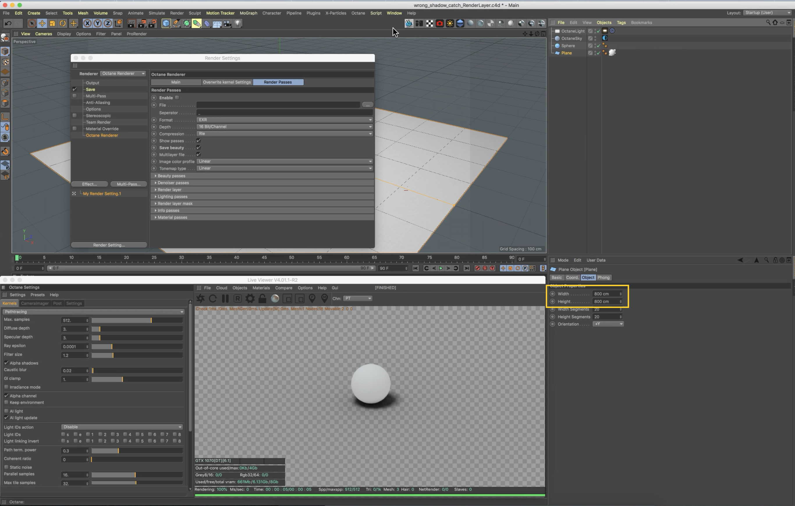

about the shadow catcher version, your plane is simply too small, if you double the dimensions, everything is working as expected:
You could use also a Floor object to avoid the issues with dimensions.

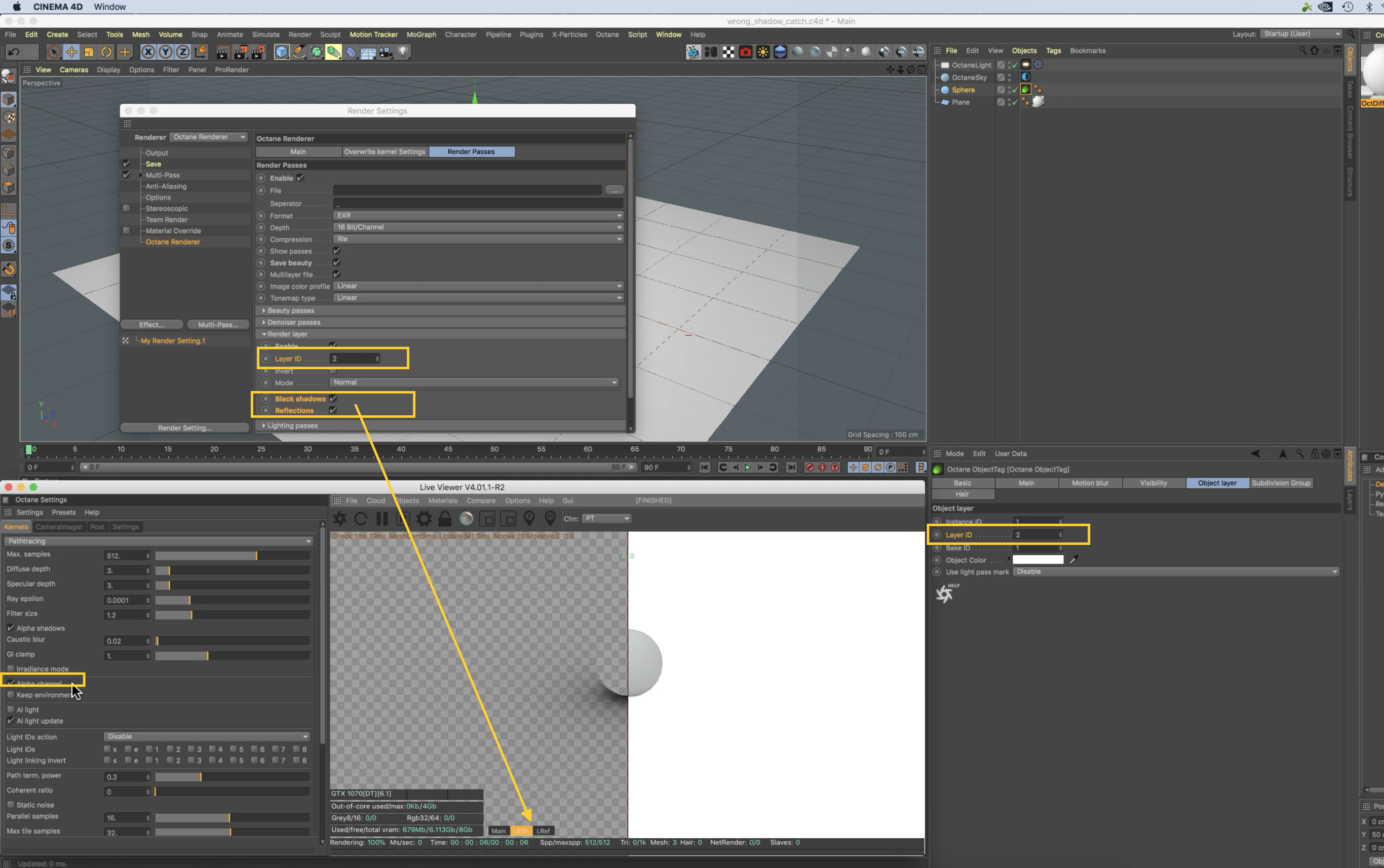

Better to use the Render Layer workflow, in this way you can use a Glossy material for the floor, to obtain also the reflections. Since by default the whole geometry is at Layer 1, you only need to add an Octane Object tag to the sphere, set a different Layer ID number (eg.2), and enable the same layer ID in the Render Passes tab, with the Shadows, and Reflections options active:
