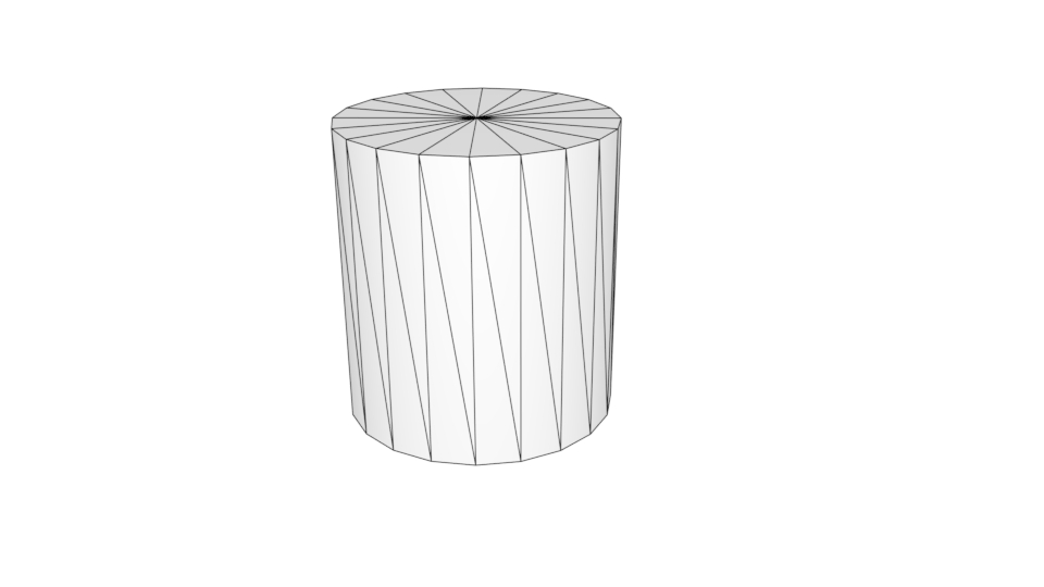

Its been a while since I used Octane and now when I render, I can only get a wireframe on a white background. No color on the material or lights work. I am not sure what I have to disable to get it back to normal?

The Kernel is currently working in Info Channel Wireframe mode, go to the Kernel settings, and switch from Info Channel mode to Direct Light, or Path Tracing, or PMC.
