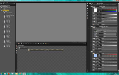

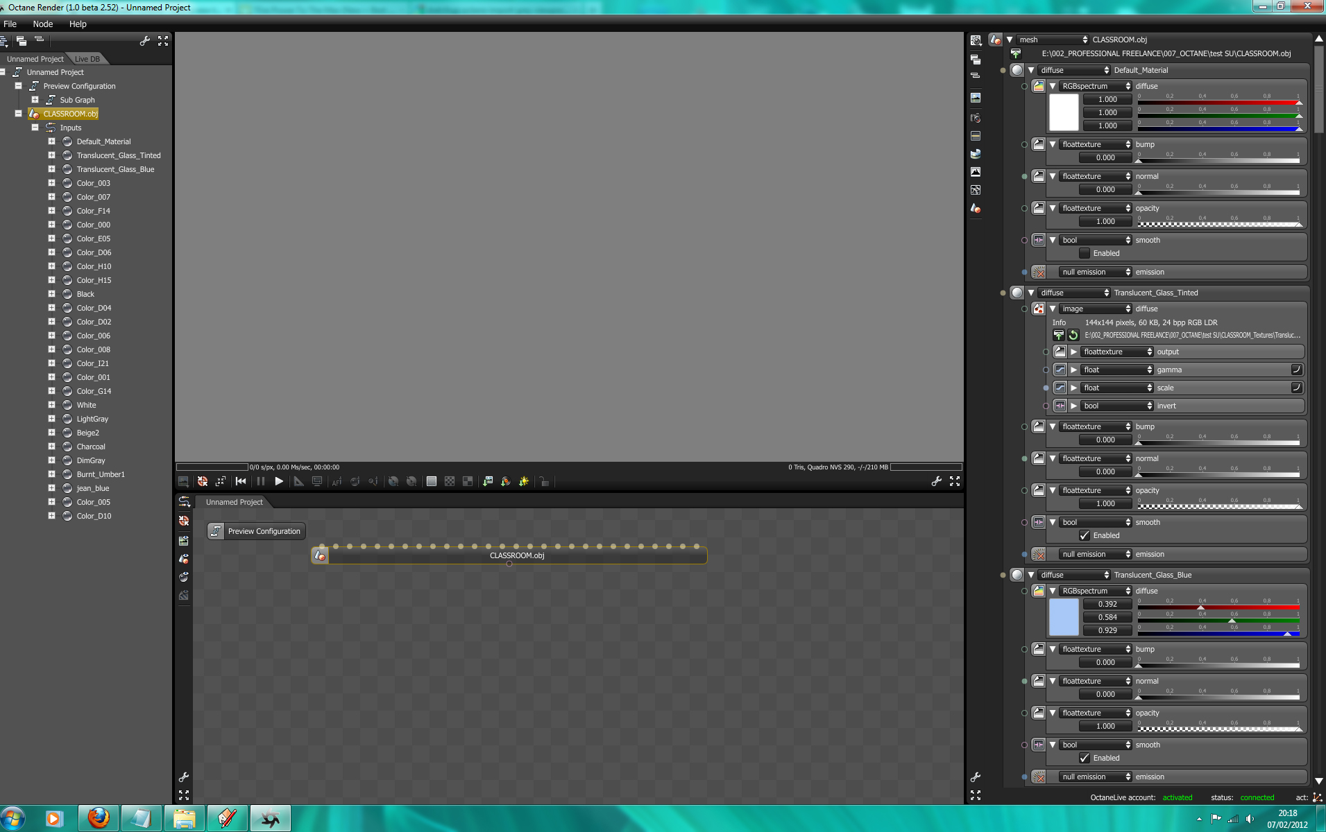

Hi guys,
i'm using the current sketchup exporter for octane but when i've imported the model, all i get is a grey viewport. also, the display show no signs of octane rendering the model as everything is 0.00.
:S
Help
___________________________________
my computer spec is
windows 32 bit / 4gb ram / intel core 2 duo @ 3.00GHz / NVidia Quadro NVS 290
this is what i see in octane.

i fixed the problem :)
it turns out that when i turn the 3d settings on ( Enable 3D vision ) on the NVidia application, things started to render.
I don't exactly know why this is. would this be do to the SLI's turning off in the process.
Anyhow, I think this was due to the settings of the drivers.
it now renders.
