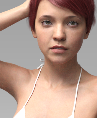

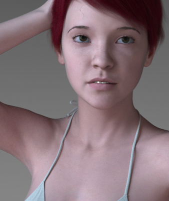

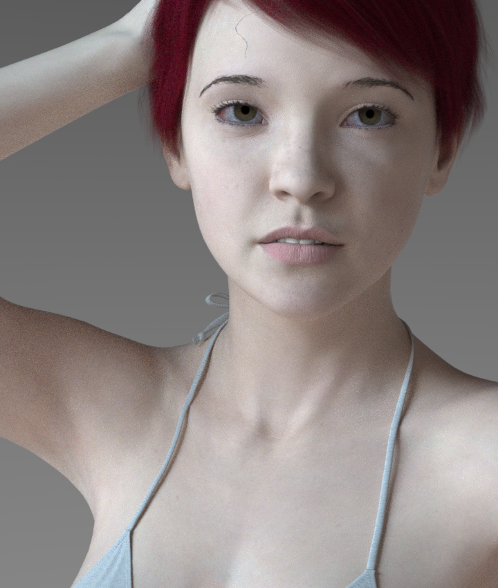

With the recent change in octane licencing it's become more affordable, therefore more users are going to consider it as an option to iray. The problem I find is when you load a genesis character the default conversion is not that impressive. Even when you remove the filters for the eyes on the main page, the eyes still seam pretty dead compered to iray or redspec. So someone trying octane out for the first time, will be impressed with the speed, but turned off with the quality. I've attached 3 version of the same render using the same HDRI file. The first is iray, seconds is default octane linear response gamma 2.2 and 3rd is RedSpec also linear. We've got to get closer to what iray can do with skin otherwise even for free octane won't be worth it, and i think with this new octane pricing it's a great opportunity to build the octane / daz user base. Redspec is very good but that red tint it applies to all files kind of kills it for me.
Iray
Octane Default linear gamma 2.2
Octane RedSpec linear gamma 2.2
Auto skin conversion needs to be updated.

Just to clarify, I can tweak both octane version to be much better, I'm familiar enough with Octane to do that. The point I'm trying to make is that someone not familiar with octane won't know what to do and just give up on it.

We used that, in order to circumvent the shader-design-layout for Iray skin shaders, where you have a heavily yellow-tinted Diffuse over a blue-/reddish-tinted version of that very diffuse, simulating subcutan skin layers.Redspec is very good but that red tint it applies to all files kind of kills it for me.
Since Octane cannot target these Iray node-channels at the same time, we had to utilize a little bit of color-filtering in order to get the textures looking as close to a blended version of the yellow / red-Iray mix.
You can easily revert that filtering, by setting the RGB color above each texture map back to 255/255/255, which reverts that filtering.
