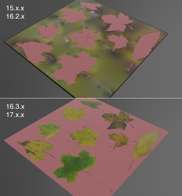

Unfortunately the Mix material in 16.3.x and 17.x.x results in inverted output compared to 15.x.x and RC v4 versions.
