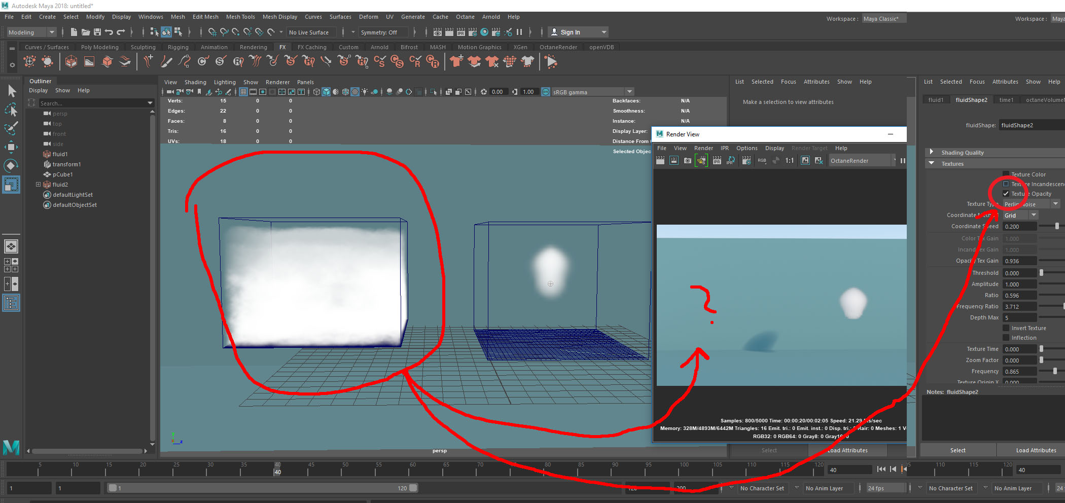

i trying to smoke, but when I do smoke using a texture it is not visible. I used the medium material the same as the figure in the right where the smoke created by the emitter. Can anyone advise me?

piwas wrote:Hi,
Thank you
The fluid support in the Octane plugin is very very limited, fluid texture grid and the dropoff grid are just ignored...
However you can export the fluid as a VDB grid with this plugin : https://github.com/bram0101/openVDB_mayaGUI
and render it in Maya trough an Octane VDB object or an ORBX proxy.

Thanks for your answer. It took me a while to figure out how to fix it, but I already have it. Now I'm going to try how it works.
