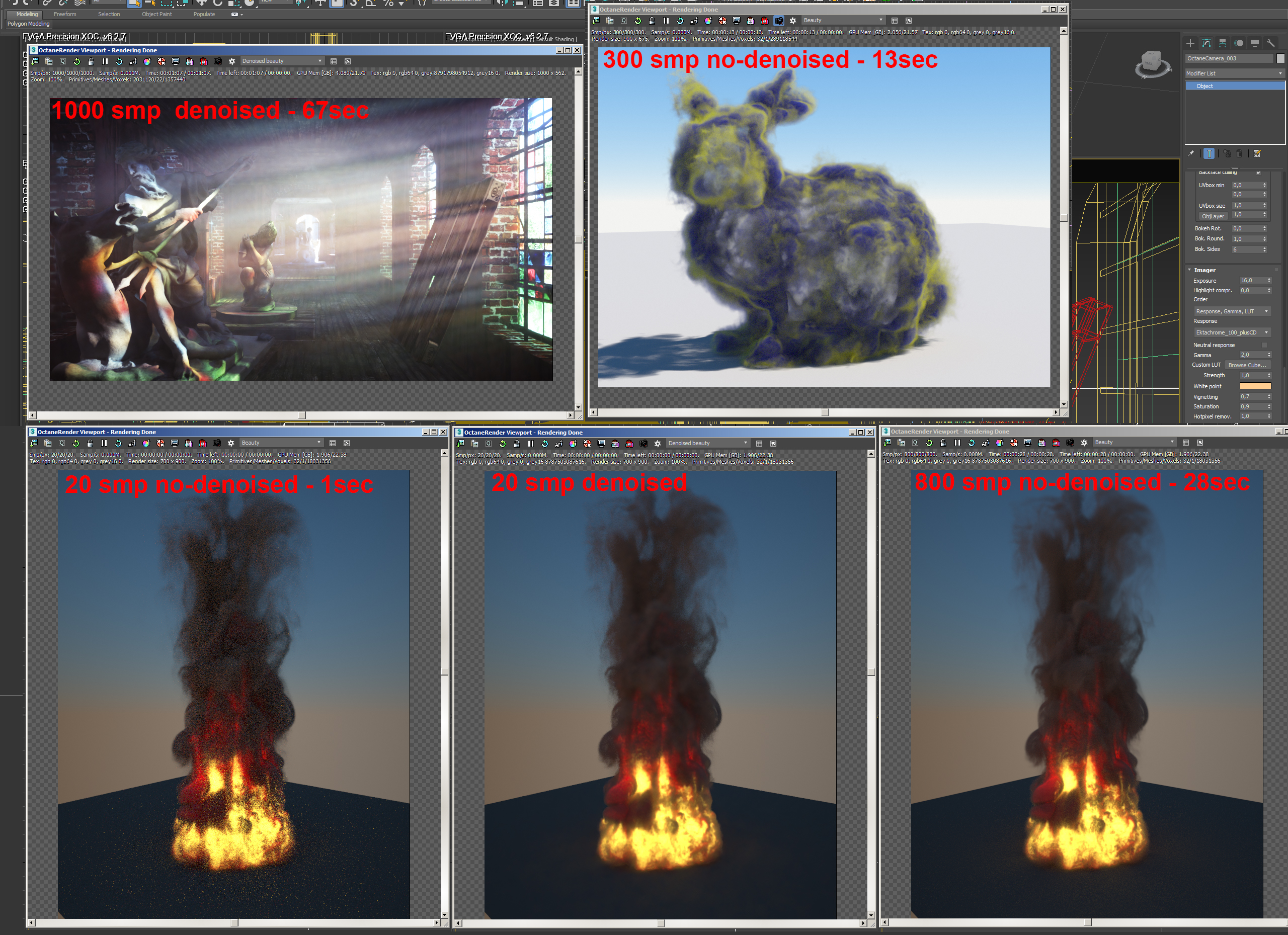

Hi guys,
I'm testing 2018.1, less volume noise and fast fog, it seems very fast.
Regards
Paride

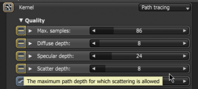

where can i find to set scatter depth in 2018.1?
otoy said:
"We have modified the way we integrate over volumes and also introduced a new mechanism that allows you to limit the scattering depth in kernel settings. Often a good result needs only a scatter depth of 2 or 3 bounces, and if you limit the scatter depth to this, you should see a good gain in performance.
We have also improved our integration which results in less noise, particularly near the boundaries of volumes. For this we keep a legacy volume rendering setting in the kernel settings, because volumes look slightly different, but render faster with less noise."
calus
Posts: 1308
Location: Paris
coilbook wrote: where can i find to set scatter depth in 2018.1?
this is only with path tracing and PMC kernels

High paride43....,
Could you post a example?
greetings Paul XYZ-Animation
