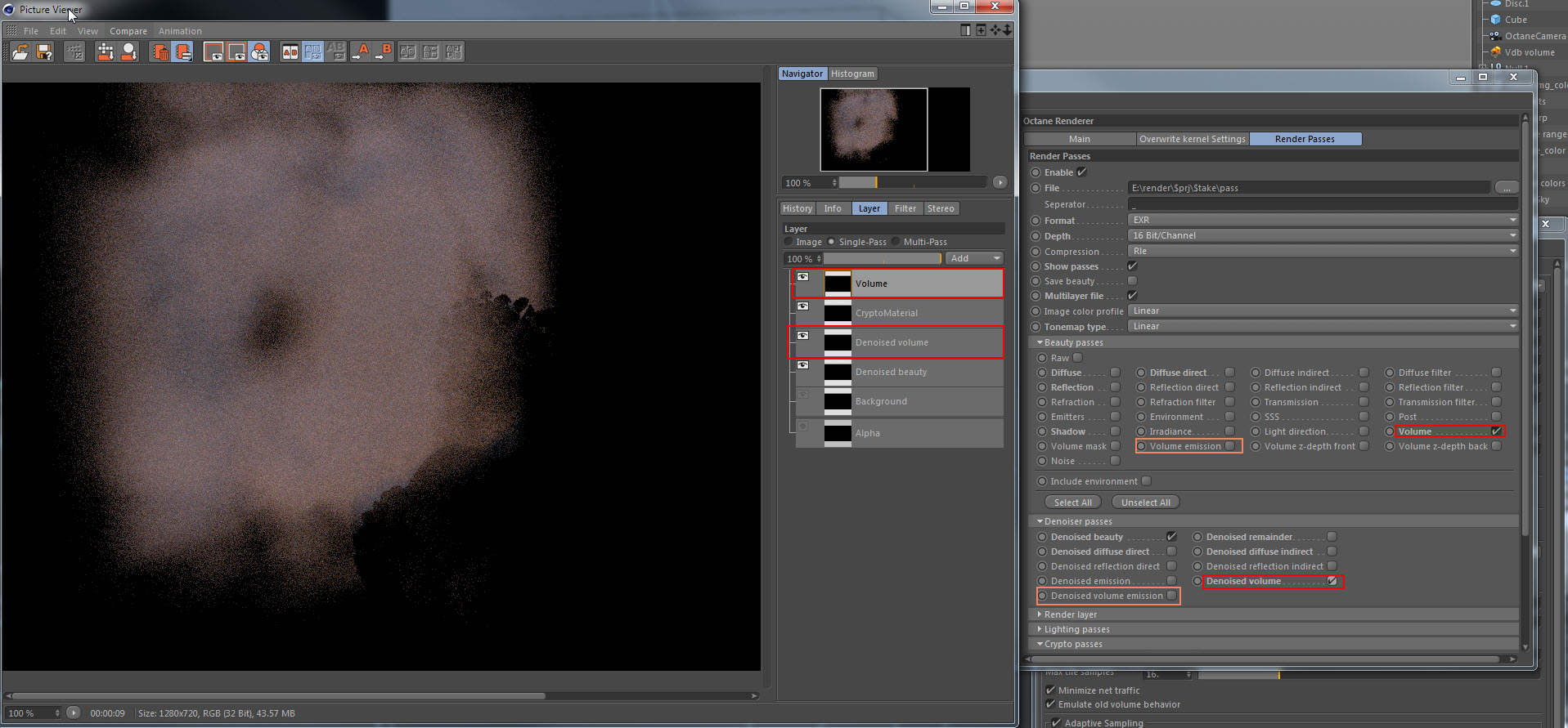

Thanks! You too!Domenicozzo wrote:Hi Ahmet and Merry Christmas to you and everyone.
Is there a way to render out denoised volumes in one take? I mean, kinda like we get thicking ON "Use Denoised Beauty Pass" in the Main Settings?
Would it be hard to include also the volumes adding a "Use Denoised Volume Pass" for future releases?
Great work with Octane 4 btw, just upgraded from 3 and it works great.
Have a great one,
Domenico
It's not easy and requires a bunch of complex coding. And I'm not sure what's the advantage while we have same passes for noised/denoised volume passes. It was great for beauty buffer because people don't want to use passes just for rendering without using passes. But here you are actually using passes and you can select denoising passes easily. Isn't?
