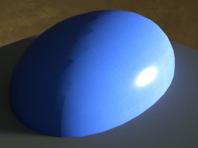

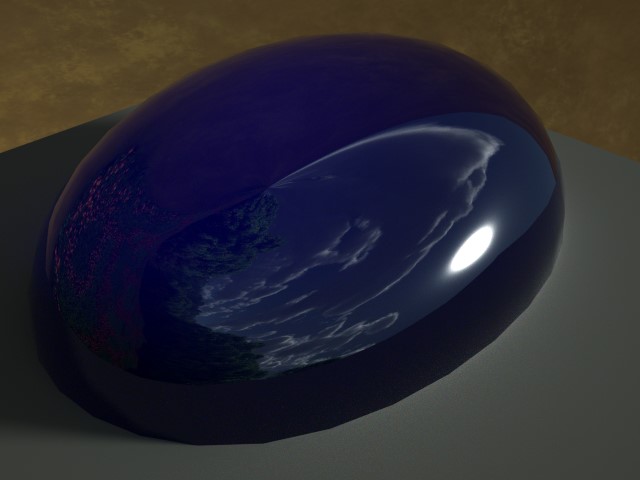

Hmmm...i dunno. I have vision issues, but here's what I got for sapphire messing with a Specular and Universal, respectively...
