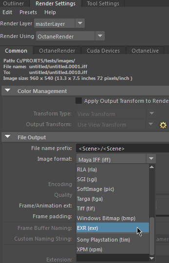

sampakinpa wrote:Hello to all,
Can someone explain me in detail how to render animation to EXR in Octane for Maya 4?

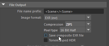

Just select EXR in the format list, after many years the plugin finally respects Maya standard workflow for this...
but still some pitfalls : Save composite EXR file is unfortunately enabled by default ...
If you don't use yet any Pass Node in rendersettings, this option should be disabled , else the plugin doesn't render any file... :shock:
