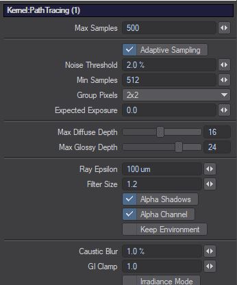

We are trying to figure out why our instanced geometry (cards with grass textures/opacity maps) are not rendering correct shadows. We did a test with a single card instanced to a null and the shadow is correct. However, the same card instanced 1 million times gives us solid shadows. Any idea why?

The problem is that you need to enable the "Alpha shadows" option in the kernel node.

AH! Total N00B mistake! Thank you!
