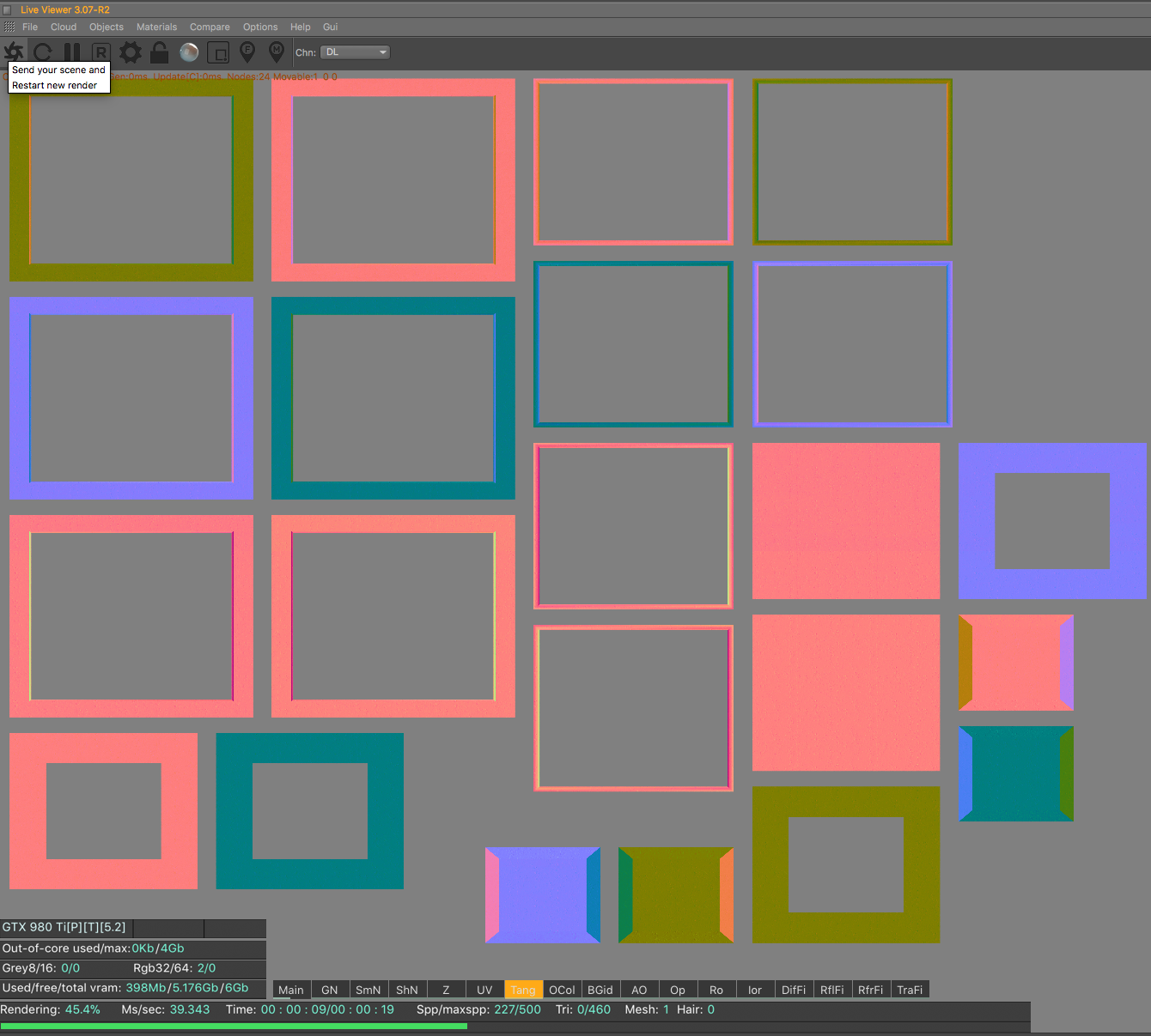

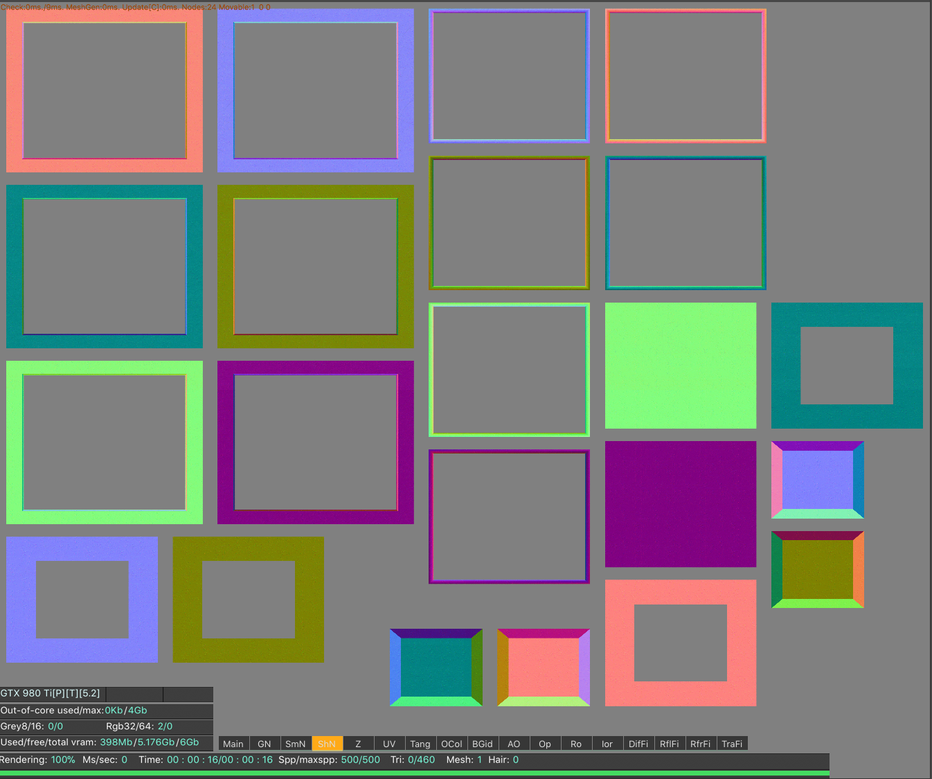

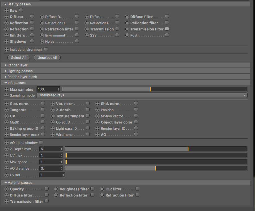

Thanks for your responses Mojave. I've attached a screenshot of the beauty, info, and material pass options within the C4D plug-in. I don't see a tangent normal option. Does that exist only in the standalone? I've tried exporting the shading normals and tangent options but both come out multicolored in a way that I don't believe should work as a normal pass. Is there a different option I should be choosing? I believe I've tried everything relevant in the options included within the plug-in.
As for the multi-pass reconstruction note, I appreciate the breakdown via nuke, but I can't quite figure out how that recombines within After Effects specifically. I've tried constructions utilizing a variety of blend modes to combine the elements you listed, but it's still not coming out quite right. Do you have a better sense of the process of recombining in AE?

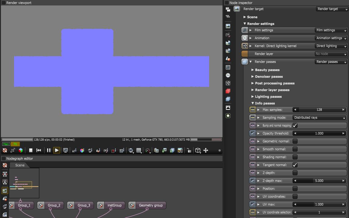

Hi
"Tangent normal" (TN) pass is missing (or broken) in the C4D plugin.
"Tangents" pass is actually "Texture tangent" - (Tang). and "Texture tangent" option doesn't do anything now. :roll:
Instead, you can use Infochannels kernel, "Tangent normal" type and enable Bump and Normal mapping.
Or you could, of course, render all passes at once in the Standalone.
Here's the missing pass (TN) in Standalone
Cheers

the feature seems to be back in c4d octane multipass with 4.011 :D
