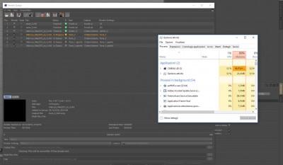

cirasa
Posts: 25
Joined: Fri May 08, 2015 3:20 pm
hi Aoktar,
last week we have upgraded Octane to V4 and since day one
we have encountered the same issue with render queue.
the RAM gets full and Cinema 4D not respond.
The scenes aren't particulary heavy so the first was rendered without problems,
but with the progression of render queue the system-RAM go full and Cinema4D can't refresh that for next files,
so the rendering will stop.
attached the screenshot of render queue.
thanks in advance for any usefull suggestion.
Posts: 16063
Location: Türkiye
cirasa wrote:hi Aoktar,
Do you have animated sequence, octane objects as scatter or volume, etc?
