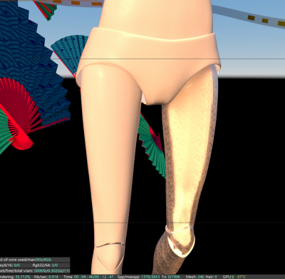

I put exactly the same material on my model, and it looks very different in rendering.
No matter how I change the lights or direction of the model, the left leg still looks like a piece of ice

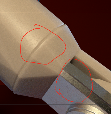

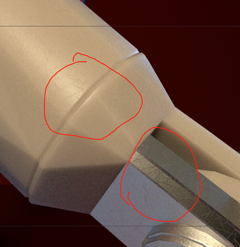

another example: in two circles I used the same material

Face normal is important. It is reverted when you use symmetry effect.

Thanks a lot aoktar! You saved my day!
