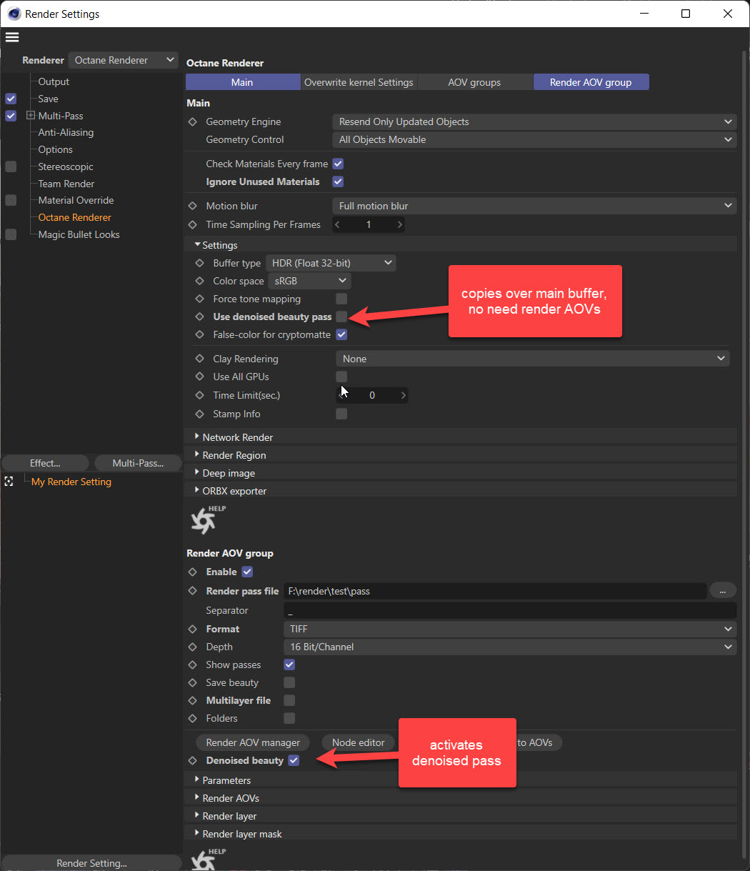

yes, main buffer + denoised beauty is the way

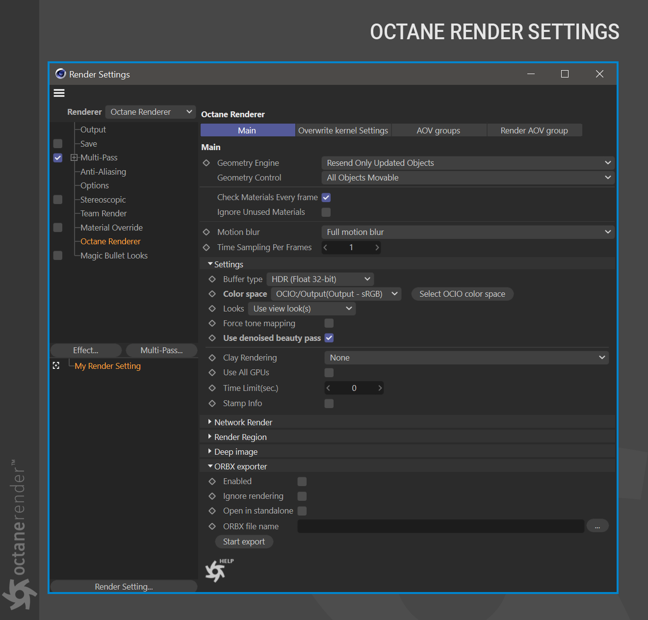

C4D Render Settings -> OctaneRender -> Main tab:
https://docs.otoy.com/cinema4d/OctaneRe ... tings.html
ciao,
Beppe
ciao,
Beppe
