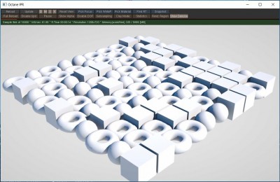

Houdini Instancing not working with 2+ instance attributes. Tested with both latest v3 and v4 in both 16.5 and 17.0 with latest supported production builds.
Image attached to show that the 2nd instance attribute for some reason gets ignored.

Sorry, I'm testing this feature here and here it seems to work fine. The "instance" attribute can point to any available OBJ node without problems, rendering all of them. Can you send me the scene to take a look a and check what could be the problem?

I figured it out, if the object the instance attribute is pointing at has its blue display flag turned off it doesnt work in Octane (it works in Mantra / Redshift / Arnold).
Here is link to .HIP where it fails. Done in 17.0.352 and 4.00.0.21.
https://drive.google.com/file/d/1lcLio_ ... p=drivesdk

Yes, sorry, currently the objects to be instanced must be enabled for rendering because if they are not extracted, the plugin can't instance them. In any case, you have an option in the Octane OBJ spare parameters to hide the master object from rendering, if needed.
