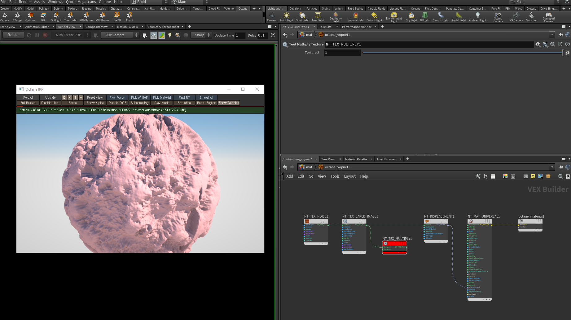

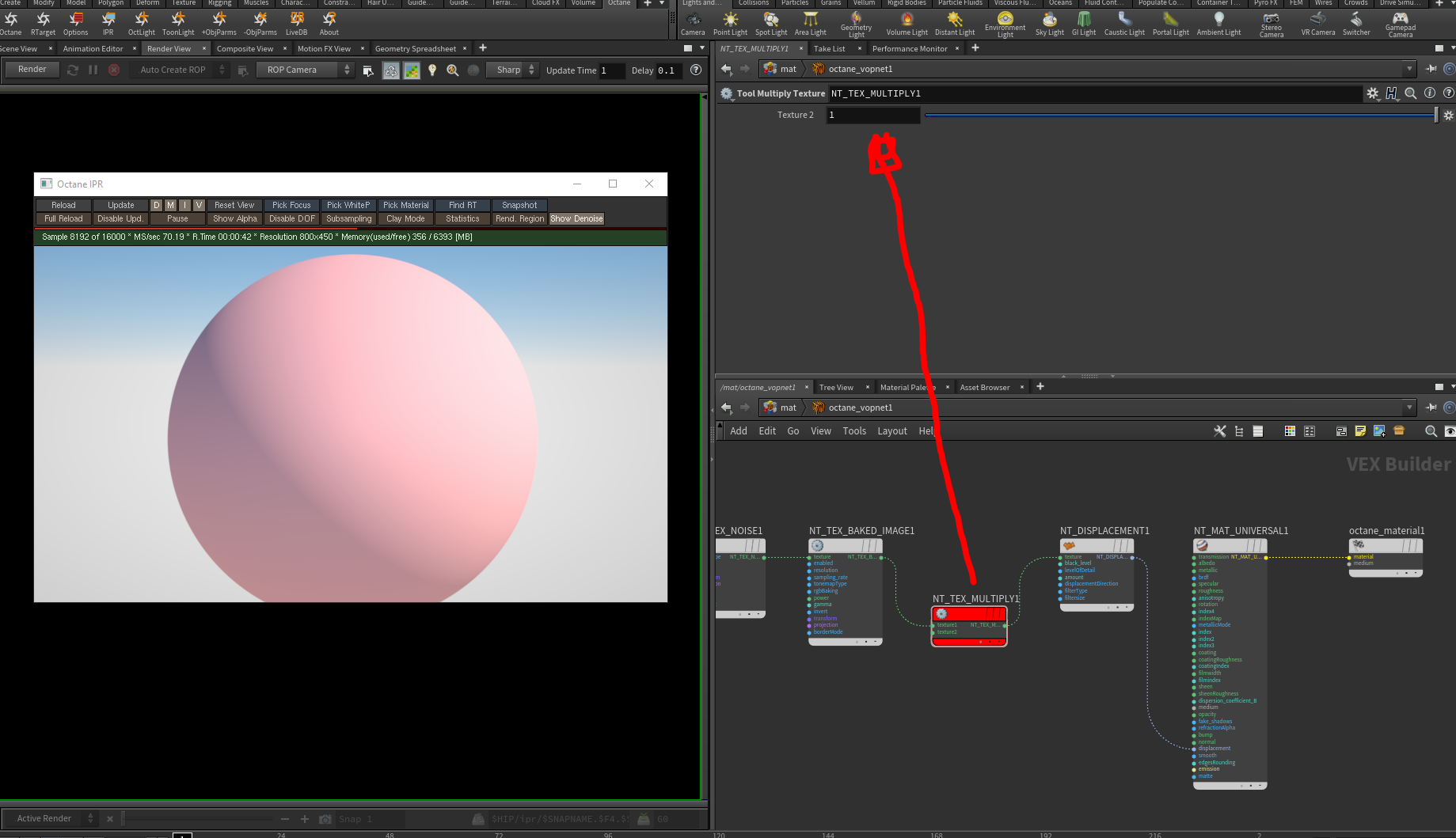

I thought maybe I could put a MixTexture instead, but _any_ type of node between a regular ‘Texture Image RGB’ and ‘NT_Displacement’ will not work. with the exception of the NodeSwitcher, when in turn breaks the HDA’s. Despite everything saying it is “color” data type.
I have attached 2 images showing that the multiply node eats up the displacment. Unfortunatly it is hard to show the other problem where the NodeSwitcher destroys HDAs because well…it destroy the HDAs =)

About the mix texture node and displacement, I'm afraid that currently the displacement only works with the texture image node linked directly to the displacement input. No other nodes are compatible with this feature.

You can actually use the bake tool in between =) But yeah..I just dislike that they state that their data type is color, because then it should be compatible with everything else that is of the type color, but they are not.juanjgon wrote: About the mix texture node and displacement, I'm afraid that currently the displacement only works with the texture image node linked directly to the displacement input. No other nodes are compatible with this feature.

Ah, yes, of course, the bake tool should work, in fact, it is there to help with the displacement from procedurals and so on.
