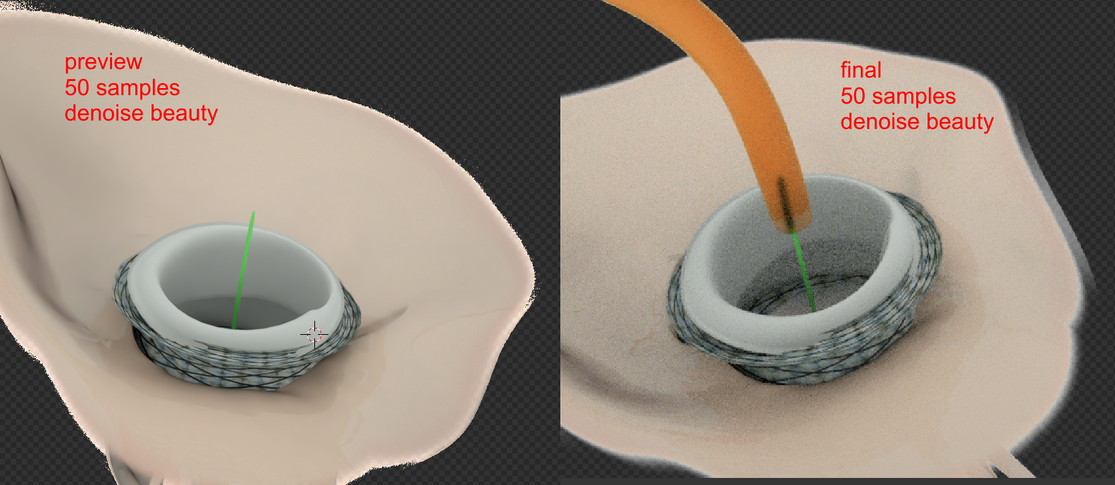

protovu
Posts: 476
Joined: Thu Sep 11, 2014 7:30 pm
Hi MIkem,
Yes, I need help on this same issue. Maybe I am missing a setting, but you can see my Preview is nicely denoised, but my Final is not.
I believe the settings are the same , in Preview/Final, but maybe I am missing a setting somewhere?
Upon finishing the final render, the top ribbon says ..."final ...denoising..", but I am not seeing it being done.
JC, maybe you can point out what I am missing?
I did employ the information from this: viewtopic.php?f=32&t=68042, with marginal improvement, but not at the level of the Preview.
Thanks,
Rick
