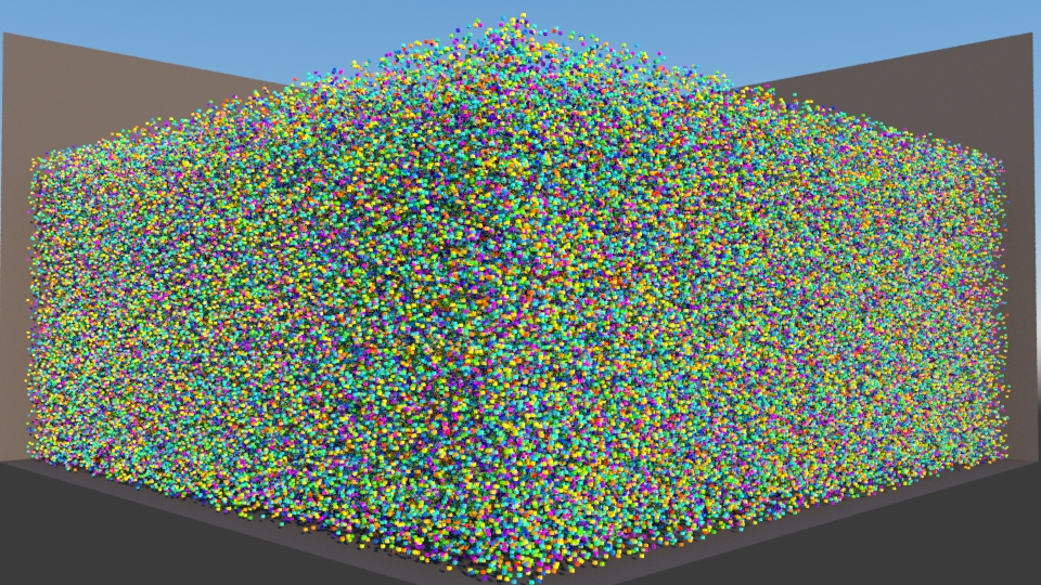

BK wrote:Could you share a sample scene?
Hi Bikram.
Here is a sample scene with the bug, this is a static particle instancer with 750k instances.
When batch rendering, the first frame have expected evaluation time (about 30s) but following frames have insane evaluation time.
the bug happen whatever value have the "frames to precache" setting.
instancer750k_BatchBug.7z
(11.13 MiB) Downloaded 306 times
For comparaison, the same scene with only 500k instances don't have this bug with batch render:
- when frames to precache = 0 : same expected evaluation time for each frame of the sequence.
- when frames to precache = 10 : slightly longer evaluation time for the first frame then only a couple of seconds for the other frames, as expected.
instancer500k_Batch_noBug.7z
(7.48 MiB) Downloaded 290 times

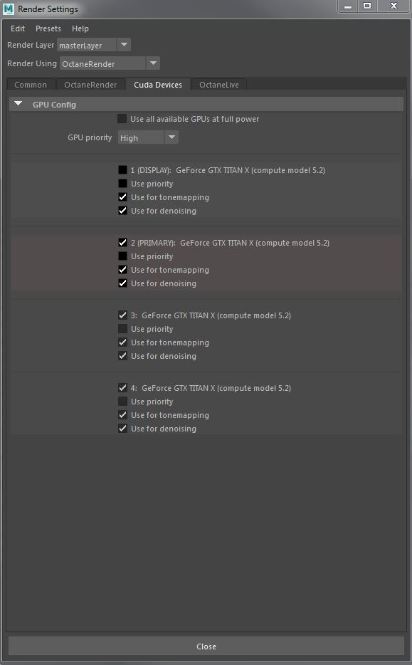

This might be a stupid question...but I'm getting some really bad general Maya interactivity performance when rendering in IPR. It seems like Octane is rendering on my display GPU even though I've disabled my display GPU in the cuda device rollout. When I stop rendering everything returns to normal. Could there be some confusion as to which GPU is my display GPU?
I've noticed my PRIMARY GPU and my DISPLAY GPU seem to be different? could this have anything to do with my poor performance?
I've tried to specify my openGL device for Maya via the Nvidia control panel but still can't seem to get decent interactivity within the Maya interface when rendering.
Can anyone help with this?
