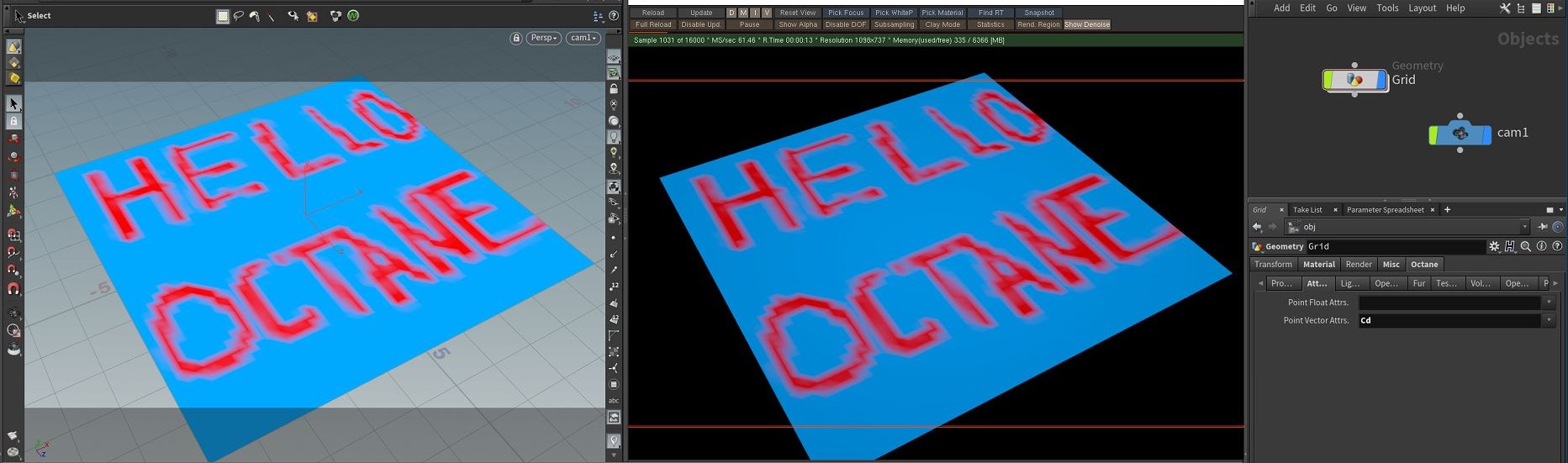

juanjgon
Posts: 8867
Location: Spain
Without workarounds ... soon in Octane 2018.1 ;)
Thanks,
-Juanjo
