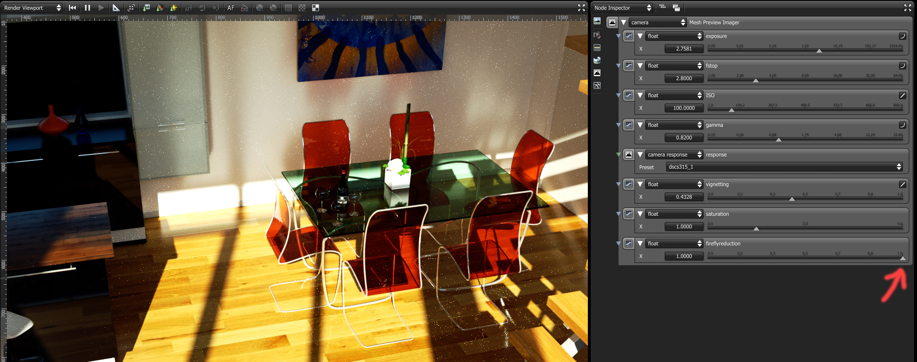

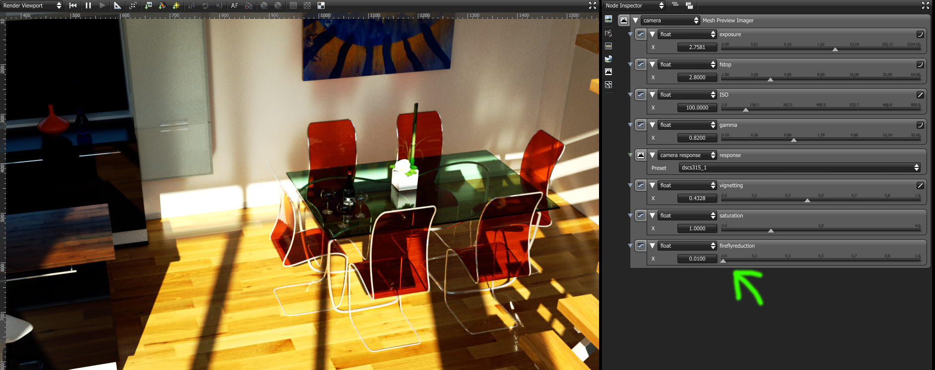

Attached an example of a final render, paused and then 2 shots of it taken, first one without the reduction (eg the slider is at 1.0 / right), the second with the reduction at nearly 0 (0.01).
The only issue remaining is unexplored caustics as you can see below the right front red chair, but the v6 will solve this with the new xxx algorithm which is nearly finished.
without any firefly reduction
with reduction at 0.1

Looks like a great feature.
But since the slider is called "fireflyreduction", I would have thought that increasing the slider (from 0 to 1) would have increased the reduction.

same here, you may want to reverse this slider or change it's name to more accurately reflect the way the control is used.
