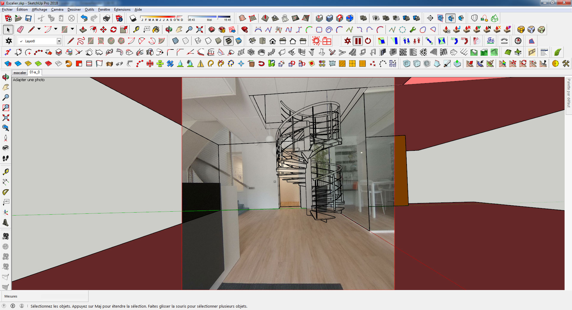

I would like to stall a 360 ° photo a staircase.
1) I extracted a cube face (front view) from the 360 ° photo
2) With sketchup (adapt a new photo) I stall the view
3) I transformed in octane the camera (camera thin lens -> panorama camera)
But 3D is not stalling well. Can anyone help me?
Is there a solution?
Thank you

In standalone you have panoramic camera (360') instead of thin lens. Don't know or care about the plugin but probably it does too

Hi, I know, I stalled on sketchup to determine the precise position of the camera and then I switch to camera 360 on the standalone. But there is a lag, yet I have good resolution. (I try with the plugin and standalone, the result is identical!). The reason is to create a 360 ° video that lifts the stair.
Thanks for your help
