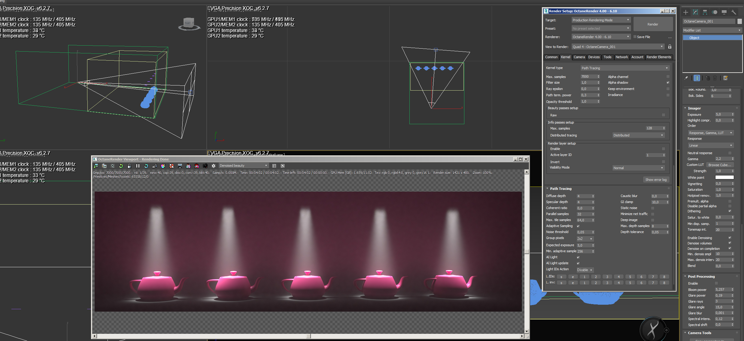

Hi Paride, thanks for your reply. Unfortunately this is not an interior scene - it's a subsea environment. Is there any way to use the volumetric fog without a room?
I've also downloaded your scene and had a look - unfortunately I get warnings about missing .IES files and the render comes out nearly completely white.
paride4331
Posts: 3994
Hi designandcode,
I'm sorry, here is a correct .zip file.
Yes you can use fog cube in external:
viewtopic.php?f=27&t=59549&p=304625&hilit=fog#p304633
a suggestion to avoid noise, Octane materials:
specular < 1
roughness > 0
Regards
Paride
01cd2014.zip
(38.04 KiB) Downloaded 362 times
