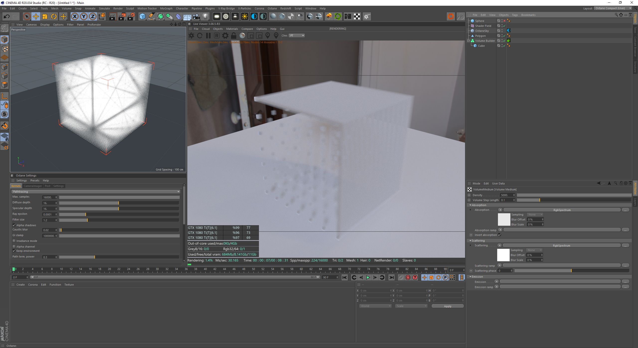

Hi Ahmet,
I wanted to try to use the new R20 Volume Builder to generate some volumes.
For example Couds and object based shapes.
But there seems to be something not working right.
I switched the Volume Builder to from "Signed Distance Field" to "Fog" to get a object filled with Fog and not just the Signed Field around the polys of the object.
For Fog the best way would be to just grab the VDB data, that C4D generates and then render it in Octane.
I would really appreciate if something like this would be possible in Octane.
EDIT:
Hmmm. Could be that its a glitch from C4D since I could generate good volumes of other objects. Might be the cube is broken in the volume builder...
Can you check it anyway?
Cheers,
