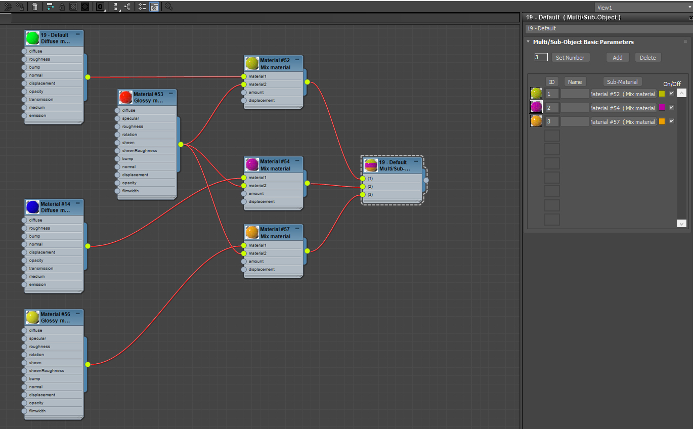

can we finally have multi/subobject material inside the mix material since octane now support OSL?
is it possible
I do not know if mix material can use Multi / Sub-Object Material because it is not an Octane node. I will investigate. Alternatively you could mix materials using Multi / Sub-Object as in the screenshot.
Regards
Paride

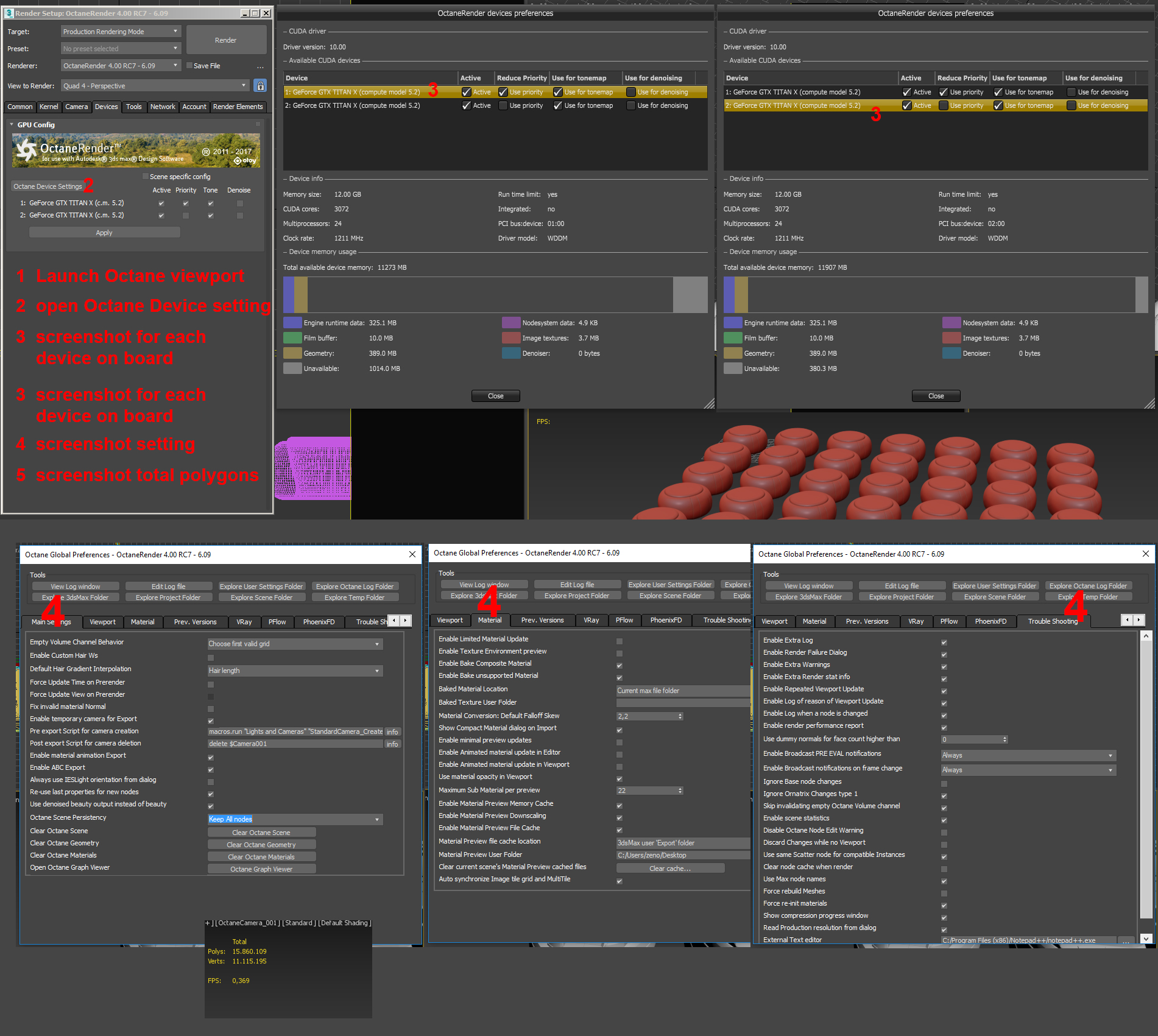

Hi mbetke,
could you share some info as in my screenshot?
Regards
Paride

I sent you PM with all the stuff and a CUDA 700 error.
