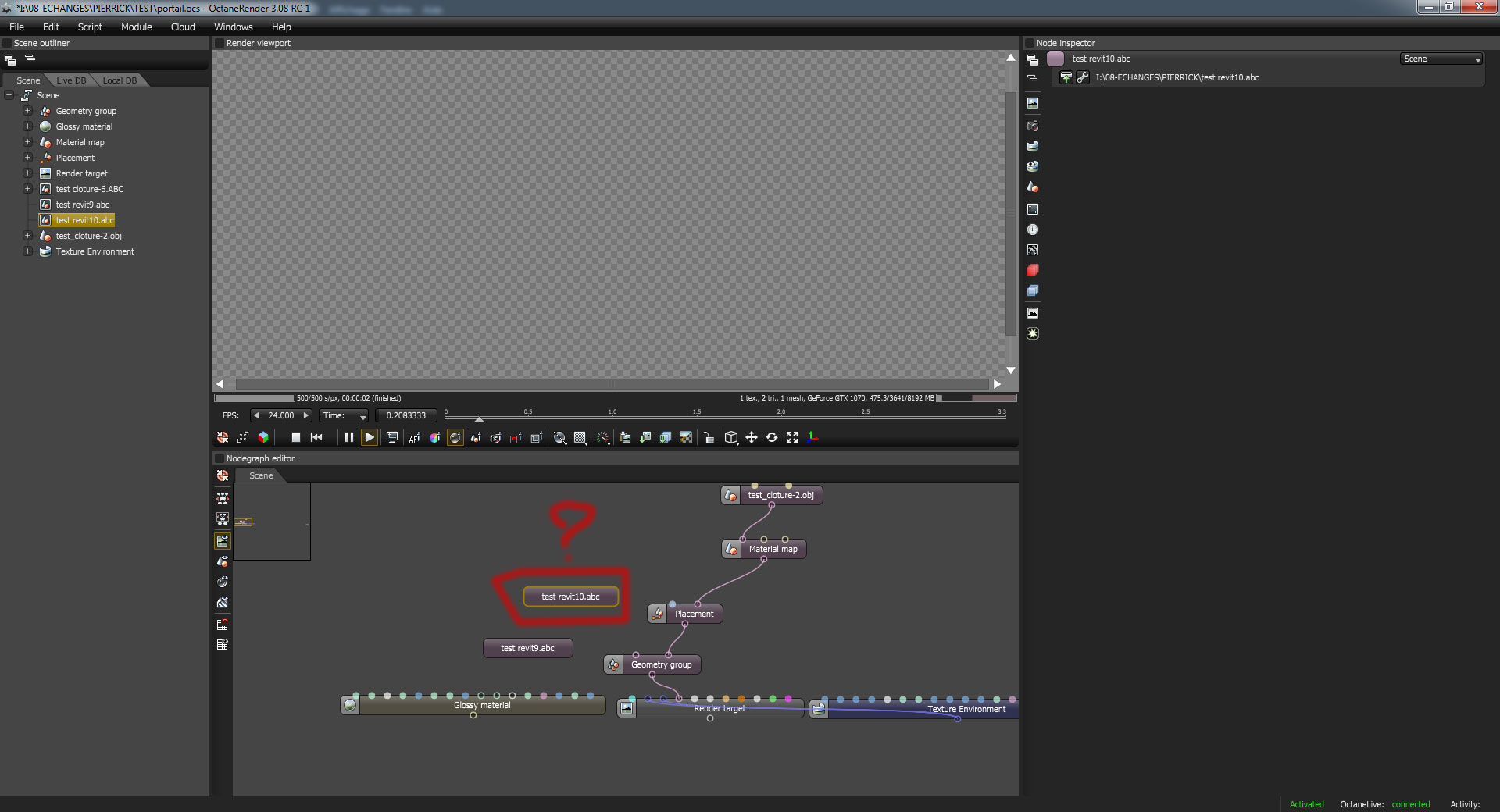

I am a beginner on blender, I would like to export a video by exporting to the alembic file, but when I import the file I have no link pin.
I do not have the blender plugin.
can you help me?
what is the best method. I would like to have the materials and the camera on the ABC file

Did you try this exporter?
viewtopic.php?f=32&t=39568

I'm confused.
What do you mean by "I do not have the blender plugin"?
If you need to render an Octane scene created in Blender using StandAlone, the best option is exporting an ORBX file from Blender directly.

He uses only standalone and wants to export a .abc file from a regular Blender version.
