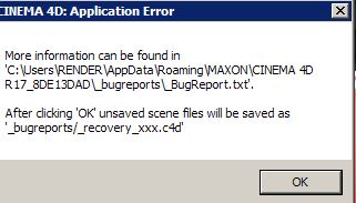

I have problem with Octane and Cinema 4D. I've got info that Cinema 4D R17 64bit don't have memory or Application error, But max only half RAM memory is used and about 800MB of 11GB VRAM. I try different version of Octane but still same (now I have 4.0 RC5). I turn off CPU/CPU OC but that doesn't help.
I also try fresh install. Still same errores...
Also I extend paging file on W7 but that doesn't help
I also attached my last bugreport log. Could you please help me? And give me any tips how to solve it?

Well, first I need to know what do you have in your scene and is it happening every scene or in a spesific one.

Sadly on every scene but sometimes after 10 frames sometimes after 50 rendered frames... Always when I render animation

Could you record a video while memory usage visible in task manager and render stats visible in picture viewer. Also I need to see console output in this video.

Try also to give a look if your Windows Paging file exist or is too small. In case you can manually set the size of the file.
Seems to be a Cinema4d (or Windows7) memory problem, not related to Octane.

Please answer to narrow down the issue, are you using render passes when this problem appear?
